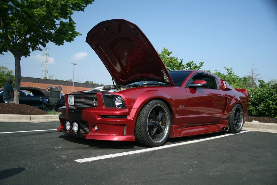

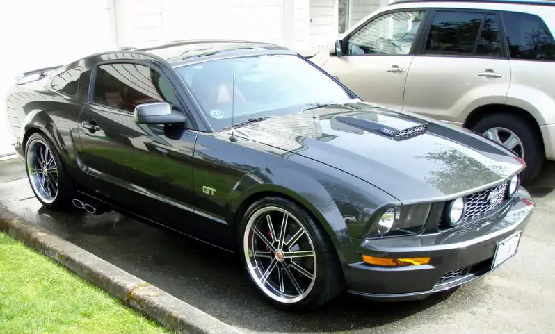

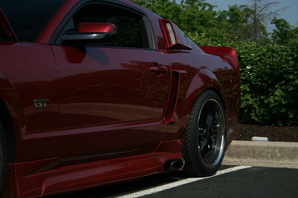

Well, I installed just the side exhaust. My ground clearance is a whopping 1 3/4". I got a little scrape on the bands that hold the tips on from the speed bump leaving work. I am thinking that I will have to start taking the long way home now. I also believe that the side skirts should be higher than the lowest part of the exhaust, but someone may correct me if I'm wrong.
pic:
