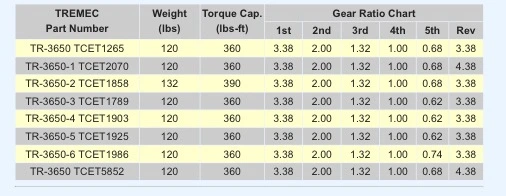

I can't say for sure-mainly because I dunno lol.
But a chart from tremec shows a few different 5th gear ratios-which would account for your highway RPM's :shrug:
