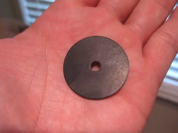

Do you have any rubber washers in between the spoiler and the hatch? On my last GT I pulled off the spoiler to make sure there wasn't any rust building up around the hatch holes. When I put the spoiler back on I put in some rubber washers. Picked them up from Homedepot. Seemed to work well. I think this is what you're referring to.
Cool, I'll check this out. Thanks. :nice:
here's the washer i used. i think they are called flat rubber or neoprene washers.

Anybody know if there are supposed to be plugs or something for the access holes to the wing studs? I think that is the source of my water leaks when it rains.
There should be some type of body plug underneath for access to the nuts, especially where the weather strip is. But butyl, plumber's putty, or rubber washers are needed between the body and spoiler too to prevent the water problem. The bottom side plugs would just trap water in the hatch and cause rust if there were no top side seal.
