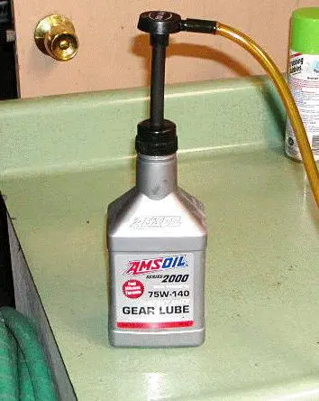

the plug where you refill the diferential is on the driver side of pumpkin, I think you take a 3/8 or 1/2 ratchet and it plugs into the refill plug and you just unscrew it. buy one of those gear oil pumps. it screws onto the bottle of gear oil, put the hose from it into the refill hole of differential and pump away. rear end work is damn messy. remember to get some of that friction addative also. you can see the plug here I think
Its been awhile since I put gears in my car. I'll look up the name of the friction addative. also I used some of the orange ATV sealant to make the diff. cover gasket. seriously get one of those gear oil pumps to help refill. One cost me like $2-4; a lot less messier. brb I'll find the friction add.

also, if you use the pump. I put in 1/2 of the 1st bottle of gear oil, then poured the friction modifier into the 1/2 full bottle of gear oil and screwed the pump back on & pumped it all in. ya, I don't think it takes all 3 bottles. just remember to add the friction mod to the gear oil before you fill it all the way up. its a real messy job man. rear end oil (especially the funky old oil) smells bad. you can wash your shirt a few times and still smell it lol

Use a pump as suggested to put the 1st quart in, then put in the modifier. The Motocraft friction modifier comes with a small spout to help you put it in the filler port. Be careful not to spill the modifier or get it on you -- IT STINKS LIKE YOU WOULDN"T BELIEVE!!!!!
Start adding the second quart with the pump until you can feel the fluid level at the bottom of the filler port (or it starts to pour out onto the floor). Replace the plug. My stock rear end took exactly 2 quarts. Since I added the bottle of friction modifier, I was left with 4 ozs. of gear oil left in the 2nd bottle of lube.
