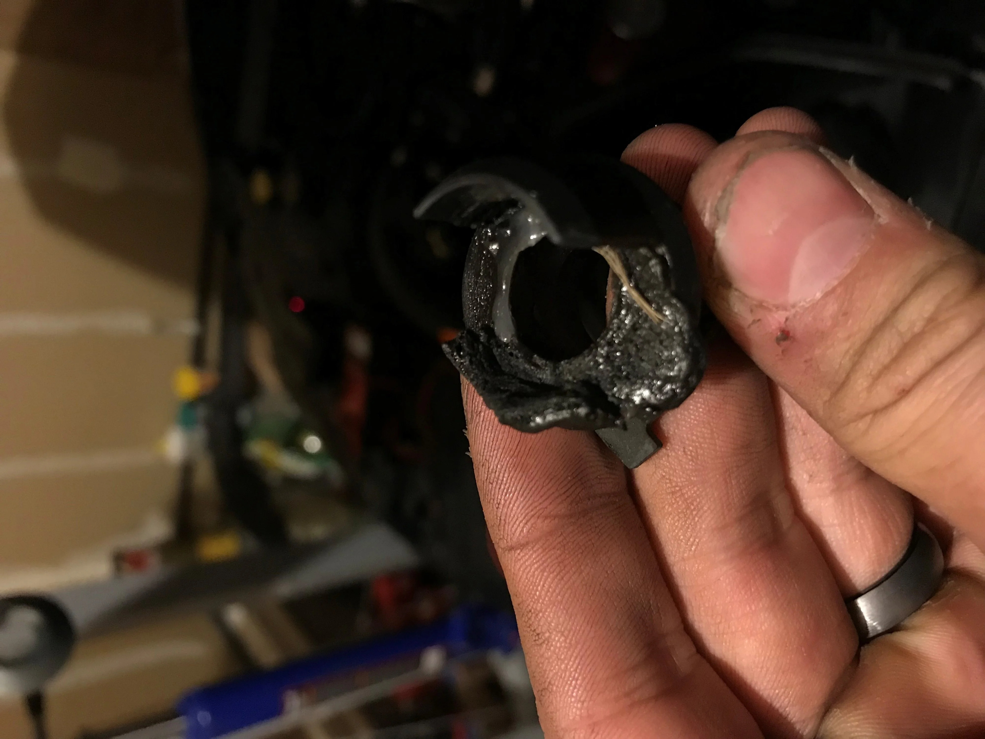

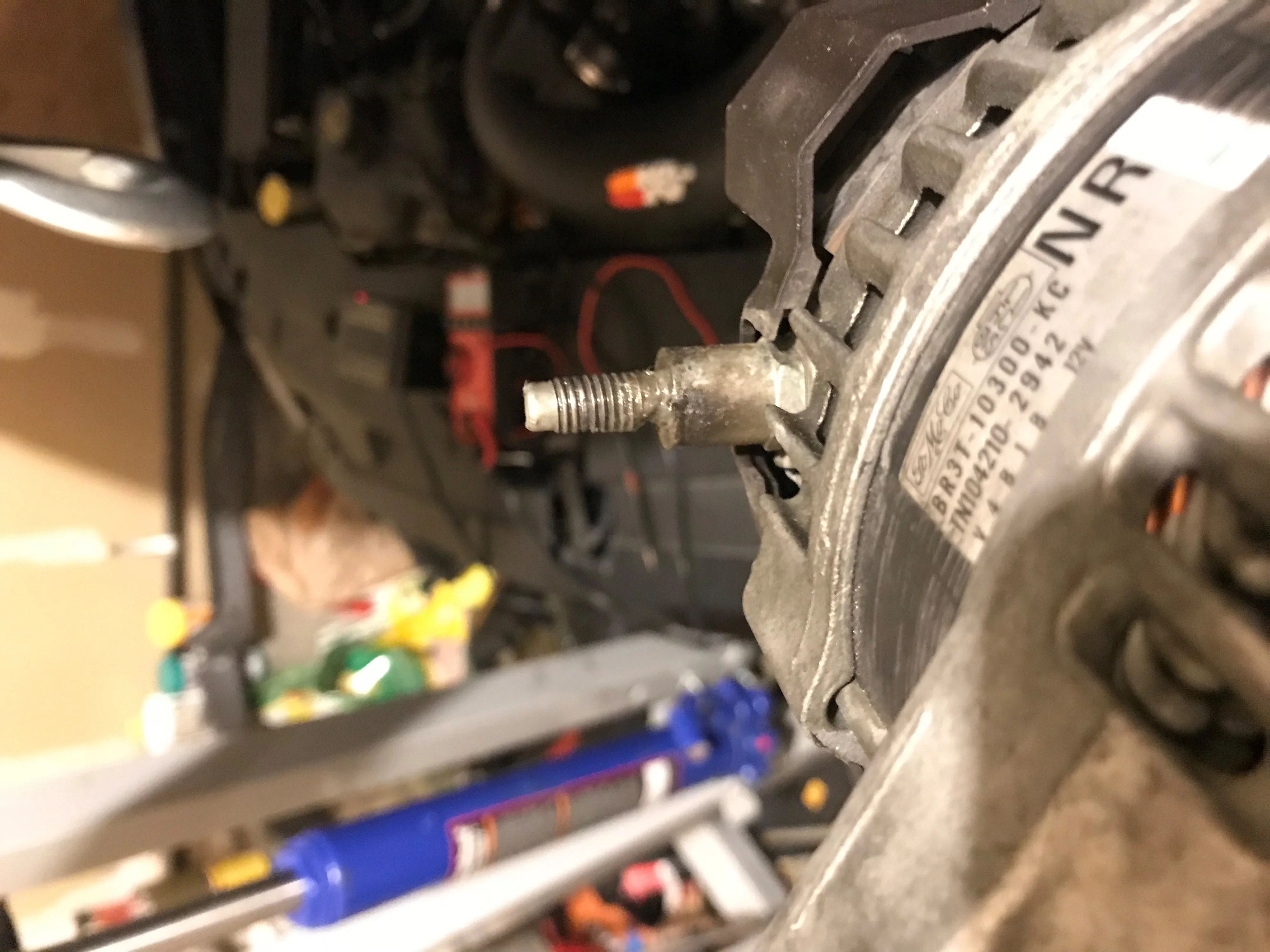

This started a while back with a checkcharging system light that came on after a car wash. I don’t know that the car wash was the culprit, I just remember it was the same night. Anyhow, I kind of ignored it as it didn’t stay on long. Fast forward a week, the car gives a burning smell, and it turns out the mounting bolt on the alternator is so hot that the platic around it melted. Also, part of the bolt literally burned away. So, I cleaned it all, brushed all connections with a wire brush, and applied grease until I could replace the alternator. In the meantime, a new symptom showed up: in the middle of driving the radio would give a POP sound, gauges all reset, and electric steering goes out for a second.

I have also attached pics of burnt alternator mount.

**UPDATE**
So I unplugged the charging cable from the B+ post of the alternator and replaced it with a 4ga Wire with a 200a fuse straight to the battery.
Worked like a charm for the whole weekend over about 50+ miles. No check charging lights or anything.
Then, 11:30 Sunday night when picking up the wife from the airport, the check charging light comes back on. This time, everything turns off - Lights, Radio, engine, etc. one second later, it’s back on.. then off. Pull over for a second to gather my wits. Turn the car off, breathe, pray, start the car - doesn’t even hesitate. Go about 100 yds and all over again.
By the grace of god it got me home after that without a hitch, but it appears something just isnt staying connected where it should!?
