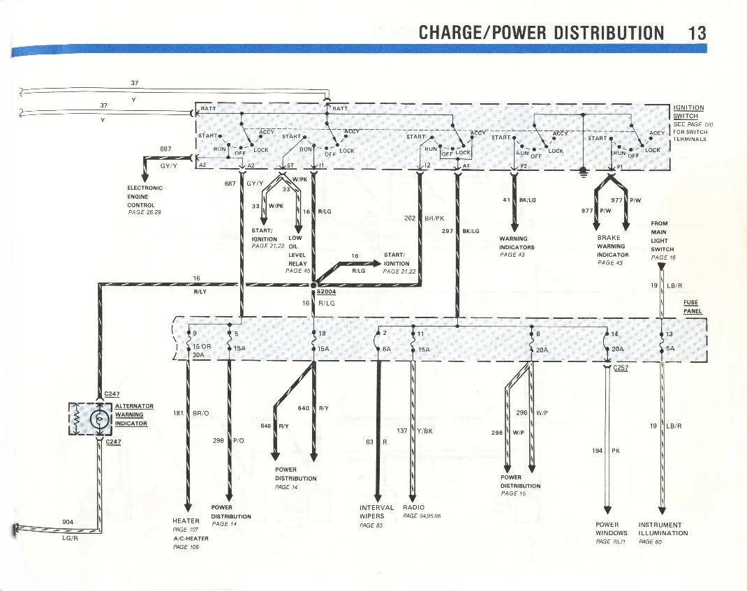

So I went through the check and my green and red wire reading 0 v so do I rerun a wire from there to the dash cause I'm running aftermarket gauges and still using the instrument panel harness

Hey guys I narrowed it down to the green wire on the regulator plug it's not getting no power so I have seen a few videos where guys either straight wire that wire to a 12v that goes on and off with the car or just splice the wire on the instrument cluster and connected 12v there is that the right thing to do or is it another way

Alternator warning indicator (lamp) is burned out, replace it.

Ion know what it was but since I'm running aftermarket gauges I just ran a 12v to the and everything is running fine thank you

@Buckstang
Post #20 gave you everything you needed to find and fix the problem.
It seems that more and more people don't seem to digest written instructions well. I haven't figured out how to chop it up in a blender and make baby food out of them yet...
You need to have either a 5 amp inline fuse or a 500Ω resistor in the 12 volt wire you added to prevent damage in case a short circuit to ground develops. The fuse or resistor needs to go closest to the source where you tapped the 12volt from. If you tapped the gage illumination power, you will have charging problems every time you dim the instrument lights.
