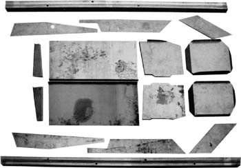

Mustangs Plus does sell a chassis strengthening kit that helps prevent body twisting and flexing.
Mustang Parts from Mustangs Plus :: Sheet Metal :: Chassis Strengthening Kit :: 1965-68 Coupe/Fastback Chassis Strengthening Kit
You can also get a Monte Carlo bar and some sub-frame connectors from them for additional support.

this is a good start, but you will also need the center cage that total control products sells, as well as either stringers or sheer panels, or both to connect the subframe connectors to the inner rocker panel. these mods will really stiffen up the early chassis, and if you add a roll cage as well, so much the better.
