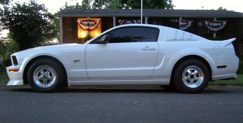

I'm on a budget, so last season I bought a pair of Saleen replica 17x9" wheels ($115 each) that only weigh 22 lbs each (vs 30.5 lbs for my factory 18" wheels). I put BFG 275/40/17 drag radials on them. Looks kinda funny at the track as the 18" factory front tires are taller than the low profile d/r's, but it works great! (See pic below).

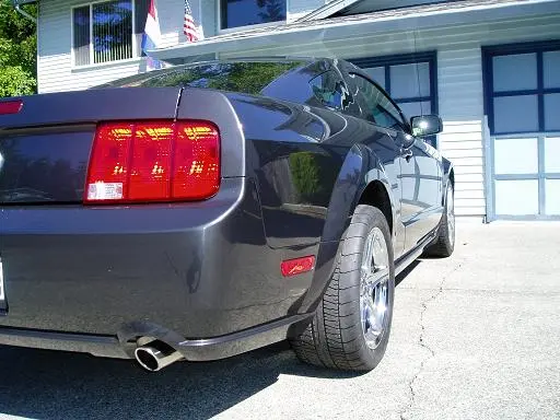

What are the spec's on your rear wheels? I would like to get as much info from you as I can as far as width and backspacing. If possible could we see a pic of the rear tires from the back of the car looking down the side of the car to get an idea of how close to the fender lip the tires get?

I ran a set of pro stars this summer but did'nt like the fit because i had to run a 1" spacer all the way around to get them to clear. I am ordering a set of bogarts for this next season weld makes a sweet set of 17s but they are crazy high priced: http://store.summitracing.com/partd...4294923105+400100+4294793320+115&autoview=sku
