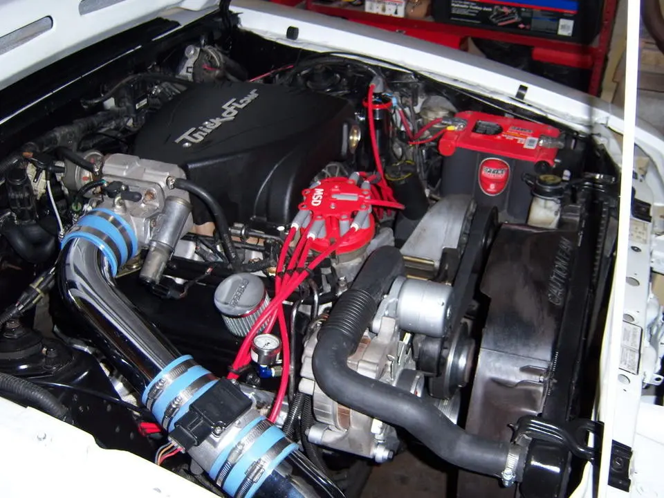

the way i was referring to use it as j rick. said you just remove the schraeder valve and screw the adapter in place... since i did that ive installed a nitrous setup on my car so i had to use that port for fuel, so now i have a gauge that screws into the side of my regualtor...
allballsmustang
Mar 31, 2005
174
Lehigh Valley, PA
Mar 6, 2009
#17
  • Mar 6, 2009
  • #17
heres a pic of my old setup with a gauge on it(note: the adapter i used is a 90 degree angle one)
