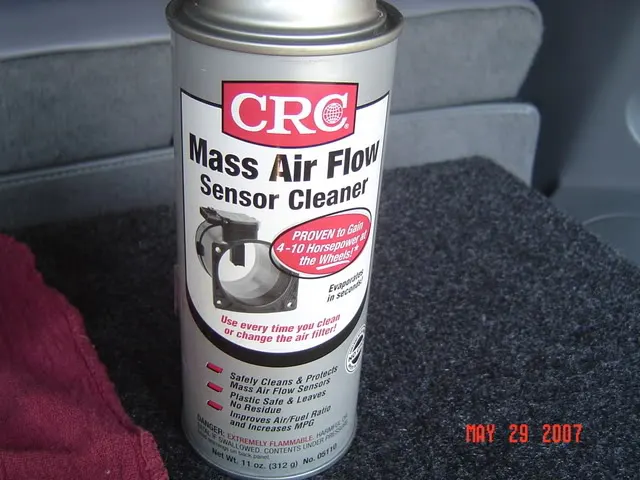

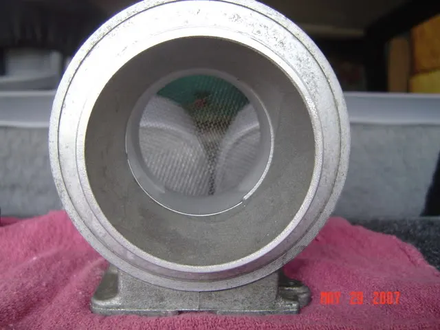

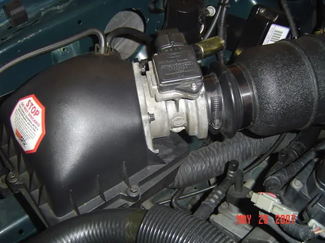

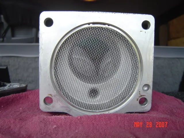

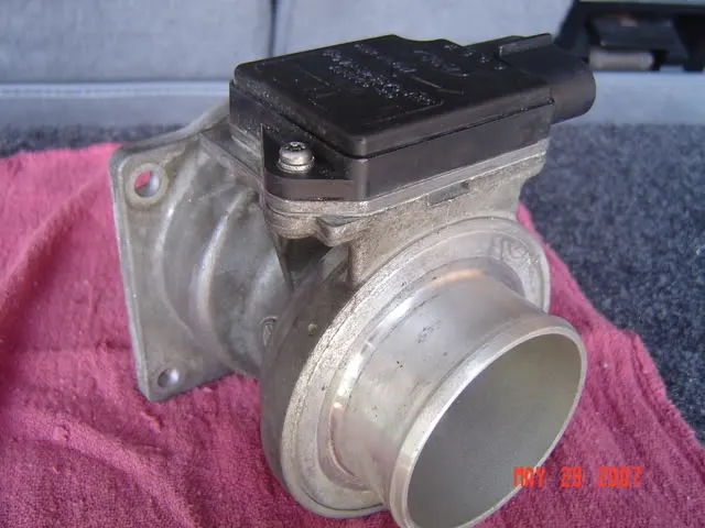

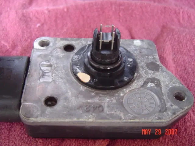

Well, got the Mass Air Flow Cleaner from O'Reilly Auto Parts and the anti-theft screwdriver bits from Autozone (cheaper). I just sprayed the sensor wires good, didn't do any wiping on them. If the light comes back on I will be a little more aggressive with a q-tip. I also used the cleaner on the mesh screen. It cleaned up nicely with the cleaner.
Here are some pics to go with the project.

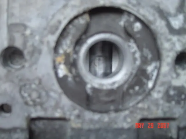

Here's a pic of the oxygen sensor they had to replace. It was the one just below the manifold, the closest one to the engine. Seems to be running a little smoother now.
