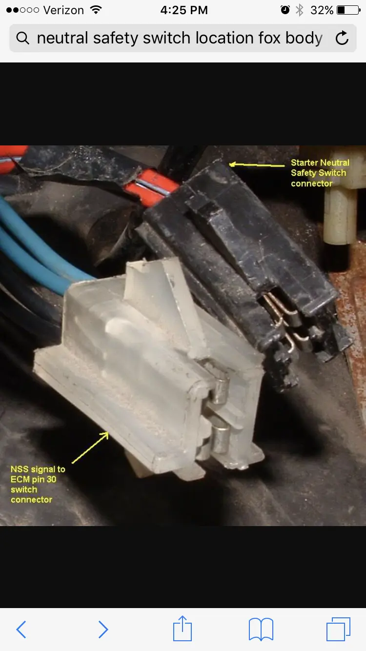

Is this the wire or switch that I should be looking for?

Those are the two under the dash that normally connect to clutch pedal. I figured a 5 amp fuse on the clear plug would jump out the code 67 but aparentky AODs are wired a tad different.
The harness you'll need to look at is under the car plugged into the AOD

Just tried this... No lights... So that means it's not plugged in somewhere or it's bad. Right? On an AOD where do I check for Connections?

Switch is on the trans at the shift lever, check the wires while your down there adjusting the shifter.

Drivers side of AOD. There's a 4 wire harness plugged into the AOD. 2 wires for reverese two for nuetral

Alright found the plug just hanging there and the harness that plugs into transmission... Question is where's the other part plug in?

There two plugs that come from the body harness to the AOD trans under the car.
The 4-wire plug is the NSS and reverse lights.
The two-wire plug goes to the Vehicle Speed Sensor on the speedo cable where it plugs into the trans
