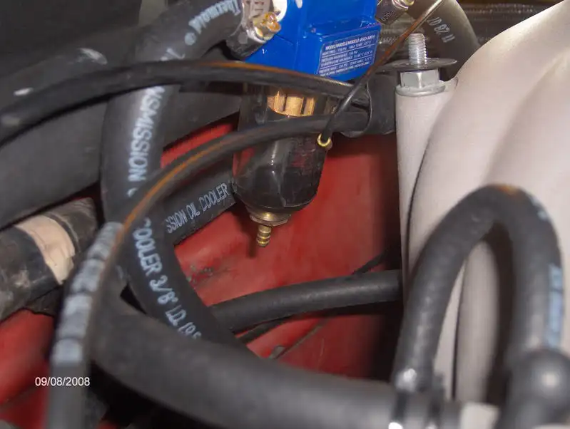

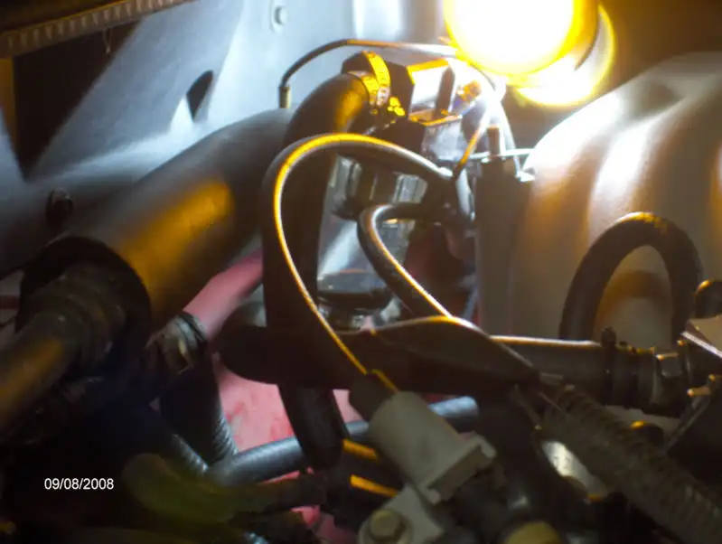

So i finally got around to installing an oil separator. Cost me a whole whopping 35 bucks total because i redid all my vacuum lines on the car at the same time. Anyway, I popped the hood to check and see if there was any oil in it and this is what i found.
So for driving 5 days, 30 miles a day this seems like alot of oil to me. Trying to get some ideas if this is normal compared to other that have one installed, or do I need to be doing some more diag to find out what the problem is.
My engine also does have almost 157,000 miles on it. Last time i did a compression test all the cylinders were between 149 psi all the way up to 160 psi.

Judging by the amount of oil in the oil/air separator, it looks like you're getting a small amount of blowby past worn piston rings. It's not bad though and your engine could go several thousand miles more before needing a rebuild. Even then you might only need a rehone with new rings.
Oil pressures are healthy so chances are rod/main bearings are still good.
