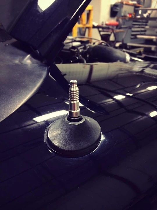

I figured that the majority of you fox guys are nifty guys and dig stuff like this... lemme know whatcha think,
I didn't really feel like drilling into the nostrils of my hood, so I went a different route for my nitrous purge.
VIDEO BELOW
A machinist at work made these for me... We decided to add a "little design" to the antenna, route the nitrous purge to it. Made out of 100% stainless steel.
What do ya think of this?
I want one!
its pretty easy. i drilled out the center with a 1/4" drill bit and the bottom with a 1/2" and pin a 1/4" compression fitting in the bottom and filled around it in with plastic weld. i use a 1/4" plastic line for my purge.
big lines = big purge if you have a big enough solenoid
You don't drill holes in your hood for a purge. You put it up under the cowl panel. That Antennae is not a bad idea. However, the idea is that you have it in your field of vision with a helmet on so that you can see when all the air is out.

you can see it still... and the biggest thing a purge is used for it to get pressure down
