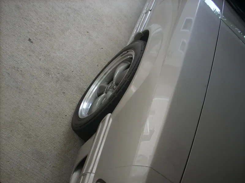

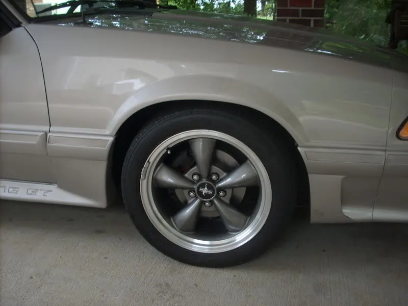

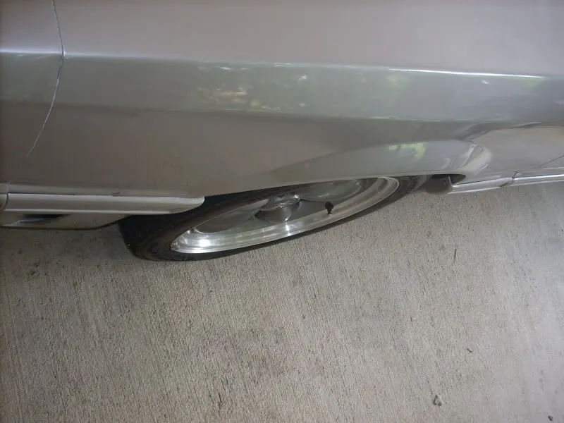

now for the confusing stuff, when it was done with the steering wheel straight the passenger side was dead on looking, then the driver one was pointed way in. so today i spun the driver side tie rod out probably about 3/4 inches and its eyeball straight, it drove home fine, just with the wheel off center.
but when you look at it the driver one is cambered in, and lower ride height than the passenger side,
DRIVER:

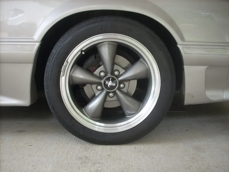

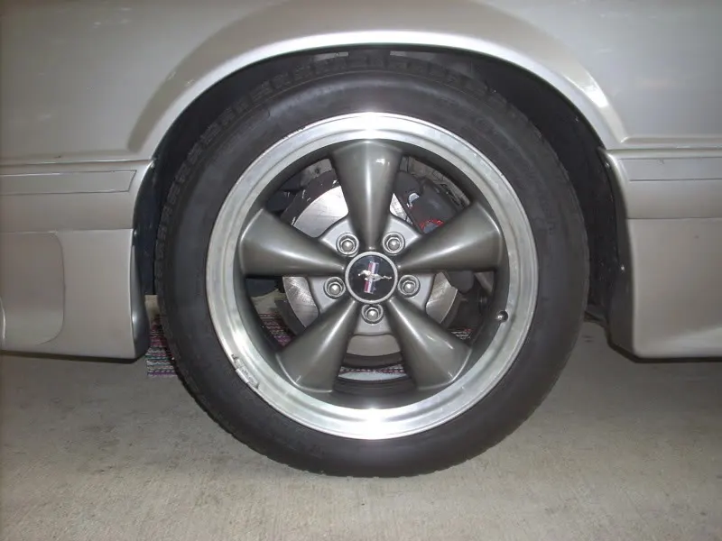

PASSENGER:

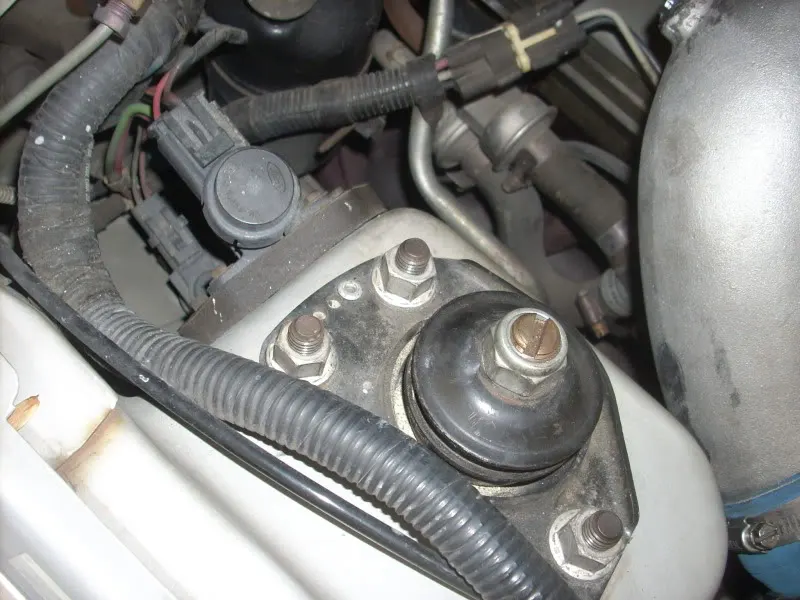

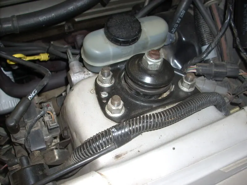

which is cambered about perfect but has a higher ride height. im not sure if the spring ever settled down into the perch in the control arm, i cant tell with it all assembled. the camber plate on the strut towers has always been different,
DRIVER:
see how the metal thing is in the middle hole?
PASSENGER:
that ones in the far right hole.

Spring won't have any bearing on alignment. It only pushes the A-arm down.
Camber is solely dictacted by the strut and it's alignment to the spindle, and caster camber plates on top.
Was it like this with the stock 4-lug stuff?
i didnt notice it, it might have been but it looked more like the driver side to me. you see the camber plates how that passenger one is on the inside hole? think that could be it? can it be how the struts mounted to the spindle?
Unless the bolts were super sloppy in the spindle, i don't see how that's possible. Everything should be toleranced such so they it bolts up with no play between the strut and spindle
no i think there all fine. just trying to figure out why that passenger wheel is cambered like it is. oh well. i just got some maximum motorsports castercamber plates for 120 shipped so ill put them on and go get it aligned.
