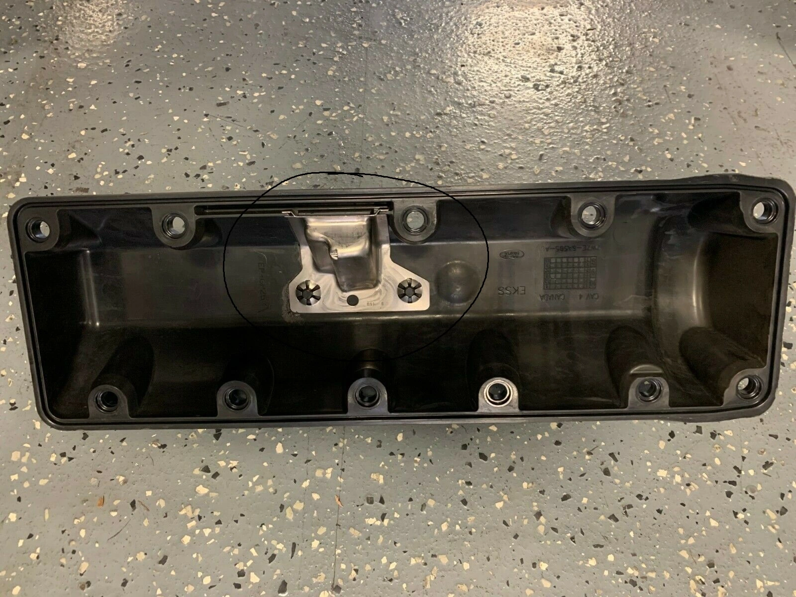

Took the driver side valve cover off, first try. No major hurdles, gasket was a pain to get back on since it was factory, but got that on also. Noticed immediately a piece of plastic sitting on there, apparantly the plastic piece of the intake broke off. It's pictured here, circled. The epoxy welds on the plastic piece look like they broke. Bouncing around making terrible noise.
Looking at the cam and valves, etc, everything looked great. Springs looked good and tight, everything tight, nothing carbon filled or dirty. Actually looked quite clean and the oil looked good. Ran it for 30 seconds with low rpm idle, only a miniscule amount of oil rolled out. What exactly is this plastic section built into the driver side valve cover? Can I run the car without it for now (car seems fine without it)? And will it affect performance? It sits right below the intake tube hole btw.
My piece is black and cheap plastic unlike the one in the picture. Should I bother trying to re epoxy the piece, get a new valve cover, or just let it go and drive it as is for now?

valve trains ... hell the whole engine, builds up some internal gases and this is the pressure vent for them on that bank ... you really should look to repair or replace as that is the correct fix. 5.0 engines are very common and the salvage yard can be a great place to find one in good nick and won't cost much more than the new valve cover gaskets that I know you are getting ready to purchase and install to prevent seepage.
salvage yards (just like people) vary in size and scope ... shop around and find one that values the customer
GOOD JOB!!
you haven't lost any ground thus far ... budgets are always a concern, include it in yours. check with a salvage yard you might be pleasantly surprised at the cost
in the past I've used them with great success to keep my vehicle on the road and kept my wits and bucks
I'd think real hard about changing the oil and filter in case some small plastic bits might be floating about ...
From what I could tell I didn't see any plastic. It looked like a straight plastic break, clean break from epoxy. Wouldn't plastic get dissolved in the valves?
Anyways I'll look for a driver side valve cover. Thanks!
