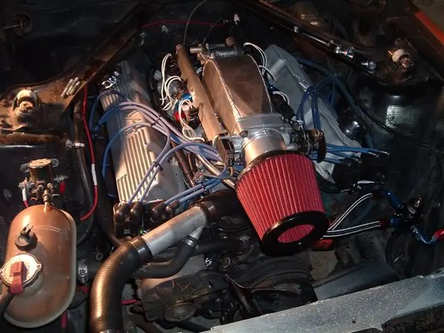

A friend of mine did nearly exactly what you're looking to do with a 351C, but with a MegaSquirt. He used DSM coils, a custom crank trigger, and a modified (cut) distributor so the oil pump would still be driven.
