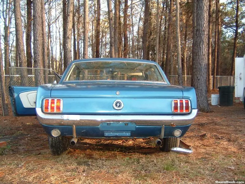

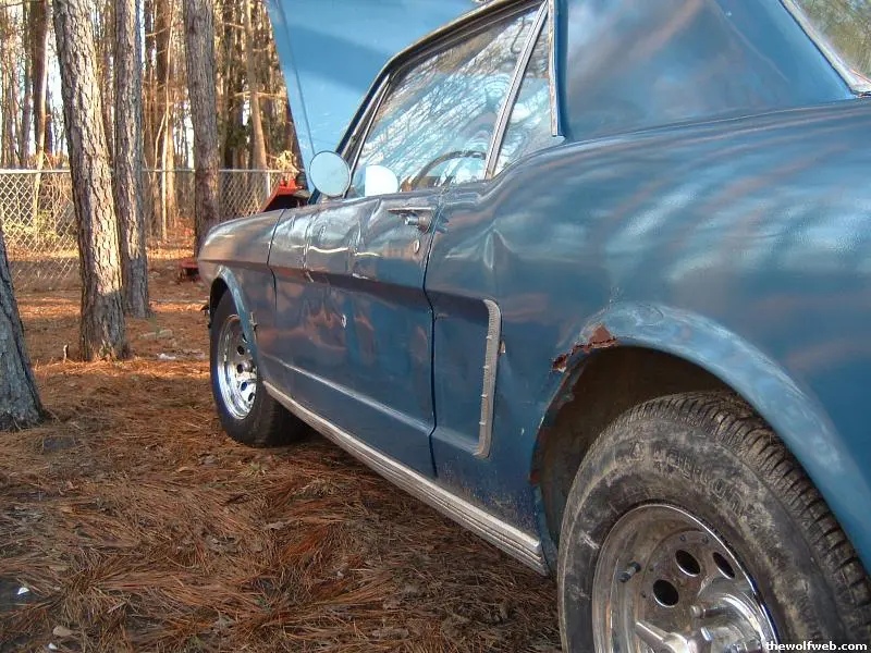

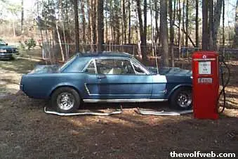

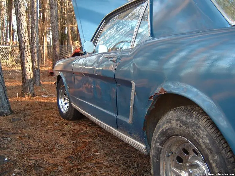

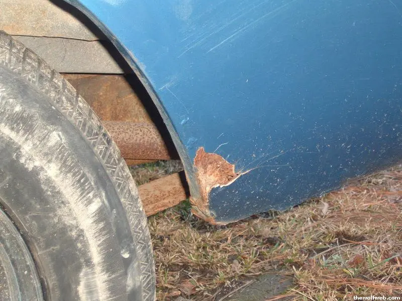

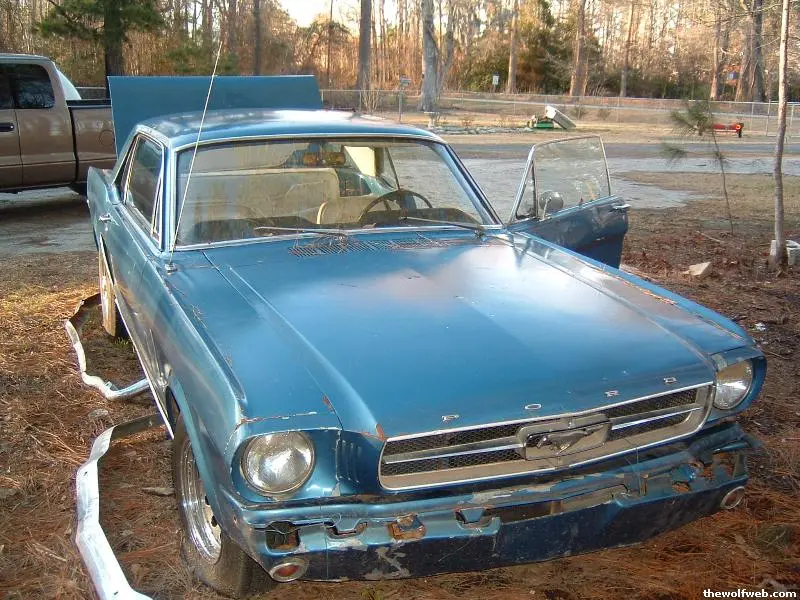

Well, I was unable to take the White one for a test drive yet again today because the bake system had some sort of problems that he is fixing today, so I went to look at the other one in the area.

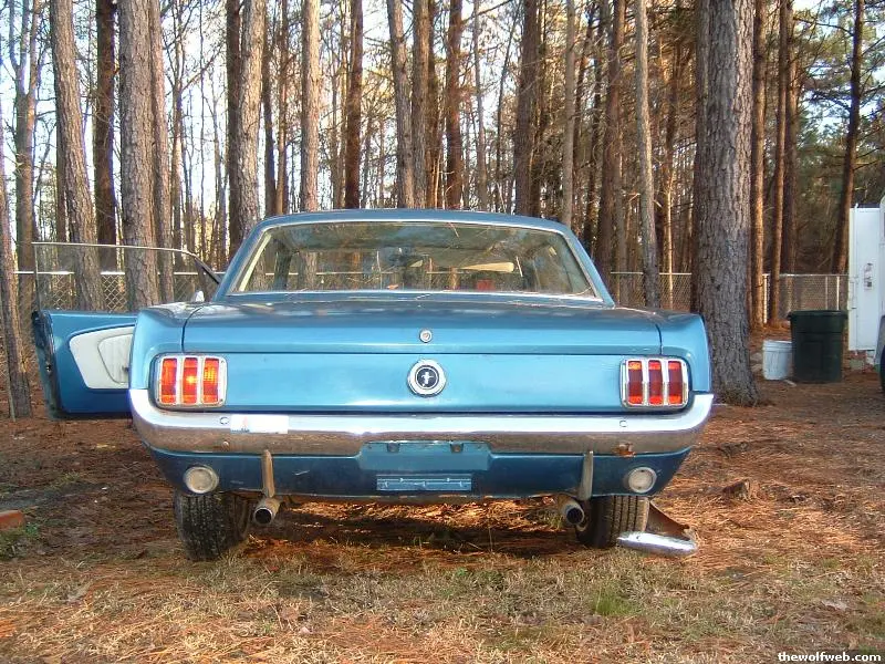

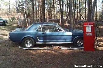

Anyway, here are the pics of that one, I got a few more of this one, but I still wish I took more. I gotta start taking more...

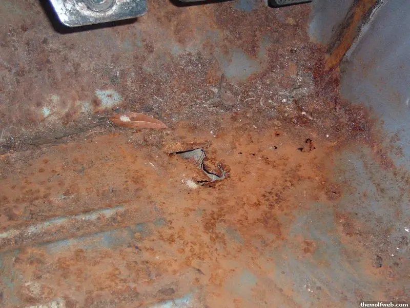

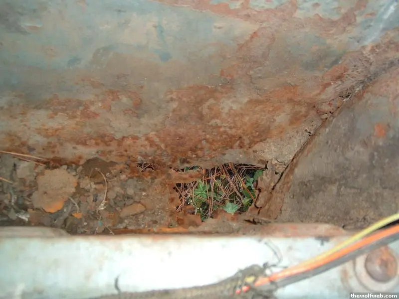

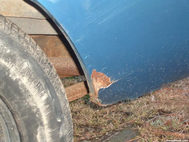

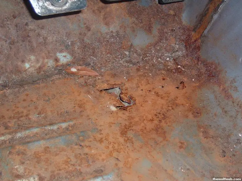

My impression of this car was it was much more solid, and it passed the water test. There was some rust on the floor pan, shown in the second to last picture, but the pan was pretty solid (stabed it with a screw driver) and there was a hole in the drivers side of the trunk (Last Picture). Looks like the drivers side quarter and door needs to be replaced anyway though. Not must surface rust, and the unibody looked rust free.
Now the downside is that it doesn't run. There is a small plastic piece on the Passenger side of the Carb that is broken, and that does not allow the engine to stay running. We did crank it up, and if you hold the piece open, it will run, he said it was the throttle body, but again, I am no Ford Expert. He also said that there was a knock in the Engine, but it wasn't running long enough for me to hear it.
All that being said, he also has it listed at $4,500, which I feel is to high. I told him I couldn't see paying more than $2,000 for a car I have to tow home, and he said as low as he could go was $3,500. HE also said I was the first person to look at it, so perhaps after a few weeks he'd change his heart.

Oh yea, and it's a 65 coupe, used to be a 200/6 from what I could tell, but has a 302 in it now. Also could be worth noting that he bought it 6 months ago, said that he didn't have time to work on it, and is moving soon. Could be true, but you never know.

take a good look at that blue one.. 3.5k is very high for a car that will need to be towed home and needs a new floor pan, new quarter panel and a new door skin.. remember its the body work and the rust work that is the biggest pain. but then again if the cowls are ok then thats something to look at.
don't give 3.5k though... look on ebay for a last resort if you have to, you can find some good deals on RUNNING cars there that you can drive back home.

Blue Jay, pass on both cars. That car is going to need a lot of rust repair, along with at least a drivers door. Also the blue one still has the 6 cylinder suspension, and that will also have to be changed. I noticed it still has the four lug spindles.

agree, thats a V8 conversion, and you can bet your last dollar the old 6 cyl suspension hasnt been touched. Changing that out adds a lot of cost right there...pass on it is my recommendation.

Well, I for one am surprised it passed the water test if the driver floor is that rusted because it sure had a cowl leak at some point. By the general condition of the car, I'd be surprised if that item has already been addressed. Also, you say it was a 6 to 8 conversion. I can't get a clean look at the wheels, but it appears to be a 4 bolt pattern still, so it may not have been converted properly. Also, just FYI, both cars seem to have a single reservoir master cylinder, so even if you were to stick with the drum brake system (not a problem I have it still) then you should at least go to a dual reservoir system for a minimum safety upgrade. Also note, the heater hoses have been bypassed, and in a rather shotty fashion, indicating your heater core is shot. The body is pretty dented and rough with some bondo evident. I think if it has only been 6 months you should ask to see the bill of sale. I'd also inquire as to the last time it was registered. Often a quick turn around with little or no work means this guy might have been hasty in his purchase, found some serious issus upon closer inspection, and is now looking to pass the problem onto the next victim. Just be cautious is all I'm saying.

If this was a GT fastback or "K" code car it might be worth $3,500 as a potential restoration project. Since its a coupe, with lots of surface rust (and probably a lot more unseen corrosion) I would pass. The cost is not the issue here...the issue is what it will cost to make it a nice car. One could easily spend $15K on it and have a car worth $10K or spend $25K on it and have a car worth $15K. The simple facts are this car is NOT as advertized, has had little or no respect and TLC, and is not a good project car. Look for another.

Wow, I thought I had a rust bucket on my hands. Sorry man but I would not touch those cars with a ten foot pole. If you want I can look around my area in Colorado for you. I did a quick search on the internet for cars within 300 miles of me and I found over 100. 40 of them under $4K. Keep looking.

pakrat, the shot heater core could have been the source of the rust in the floor instead of a cowl leak.

Yeah, I suppose that's possible, but usually they tend to trickle for some time on the passenger side, not the driver side. If it was the culprit, then in my mind the entire contents of the radiator would of had to spill out to raise higher than the hump in order to seep into the drivers side and then it would of had to either been left unattended and stagnent for some time or have cleaned up half assedly to cause that much damage. I'm not saying it's impossible, but I think it is less likely than a bad windshield seal or a cowl leak.

Mine actually leaked at the windshield. It could not be seen just squirting water, cause it would run down behind the trim, behind the dash, and under the carpet. Your right on the core, did not notice it was the passenger side. I agree on the passing of both cars, I posted a link for a decent prospect in his home state. Hopefully he will stay patient, cause those other two owners are a little too proud of what they have, IMHO.
