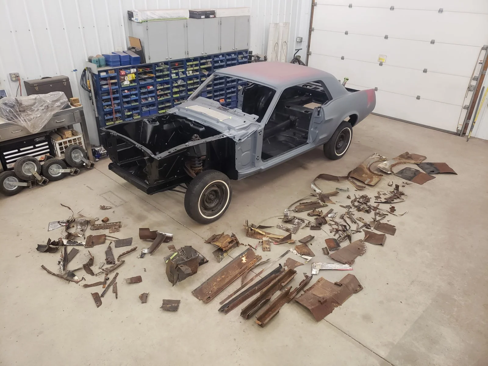

Hey All,
I've gotten my '68 coupe back to square one with a whole lot of new metal. She's all cleaned up and sealed up, just about ready to be put back together in slow fashion. Short of what little old paint is left to strip and re-prime, I'm looking towards modernizing the front and rear suspension as my next big ticket expense/project. I'm hoping this community could give me some guidance on some of the must-have's and not-so-much components in an upgrade. For an easy riding cruiser, do I need to consider all out Control Freak-style suspension, or would new upper and lower control arms, sway bars, etc. suffice?

Holy crap is that all the stuff you cut off that car?

Thanks 2Blue! Yeah, from this latest session of progress over the last few months, that's all she gave up! I've been very blessed to have an old family friend mentor me in the metal work.

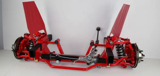

This one is from Rod and Custom with coil overs, power rack, disks, big sway bar, and room for that Boss 429 or coyote engine you been dreaming of.
but most m2 will need a rear sump oil pan swap.
