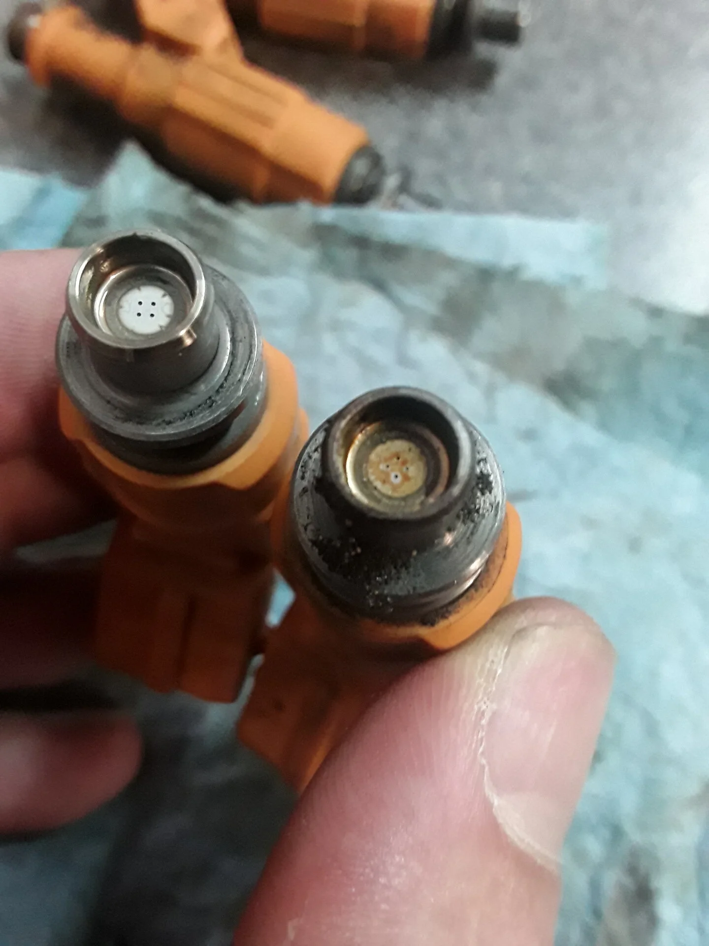

I just did mine in a varsol tank/wire brush. Cleaned up very well on the spray holes!
Hope yall appreciate that picture b/c i spent like 2 minutes getting it to focus with my phone. Lol.
