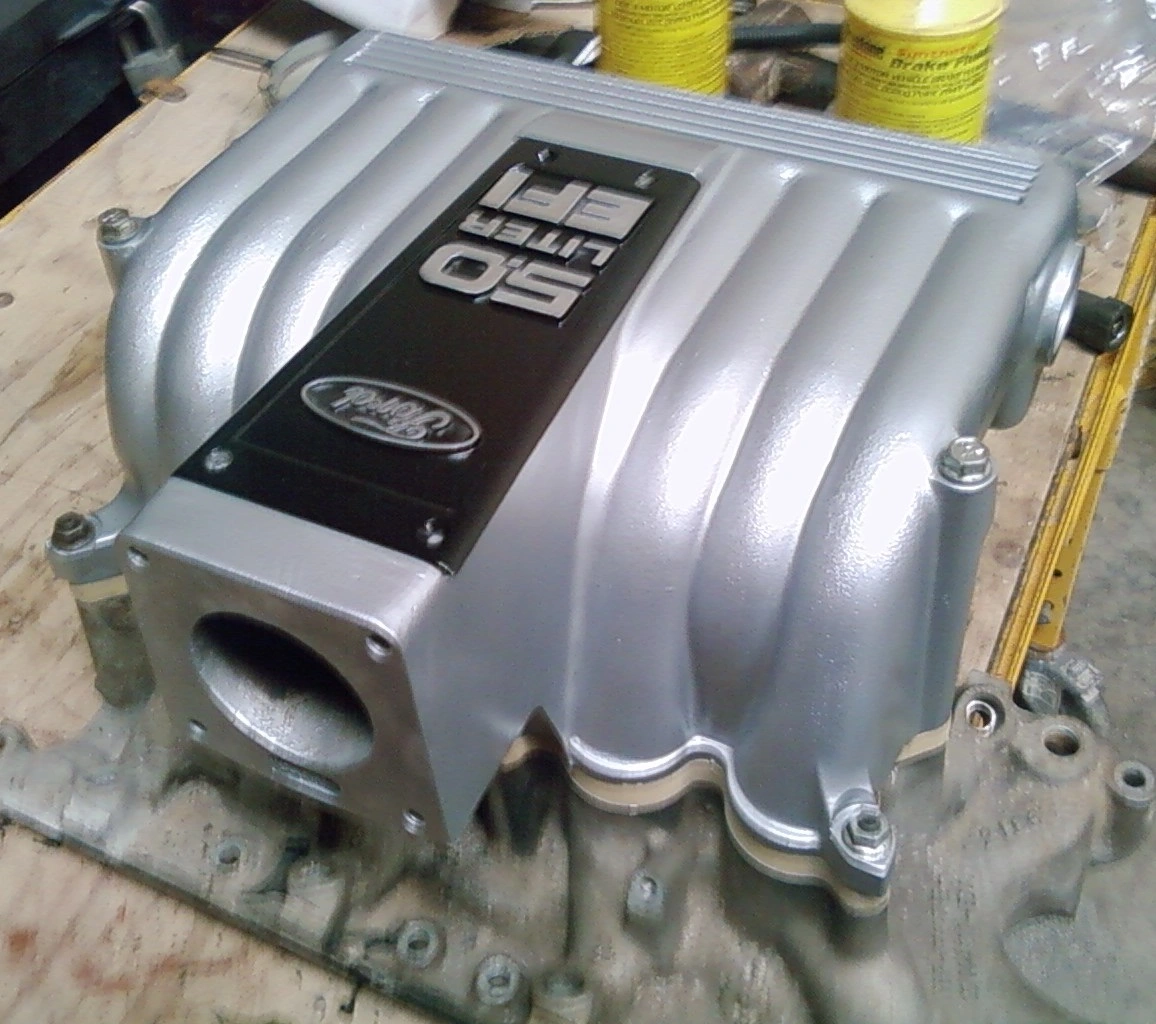

Cleaned up the Exploder upper...
ratio411
Apr 21, 2002
3,870
73
109
Pensacola FL
and it turned out better than I thought it would.
Always nice when that happens. :)
I was going to drill/tap the 2 additional plate holes needed, but now I think I am just going to cut the head off the 2 spare screws and epoxy them to the plate, just for looks...

The lower has never been retrofitted to a Stang.
It came out of the u-pull and has been on the shelf since.
The upper spent some time on a Fox, and has been cleaned up a couple times in stages.

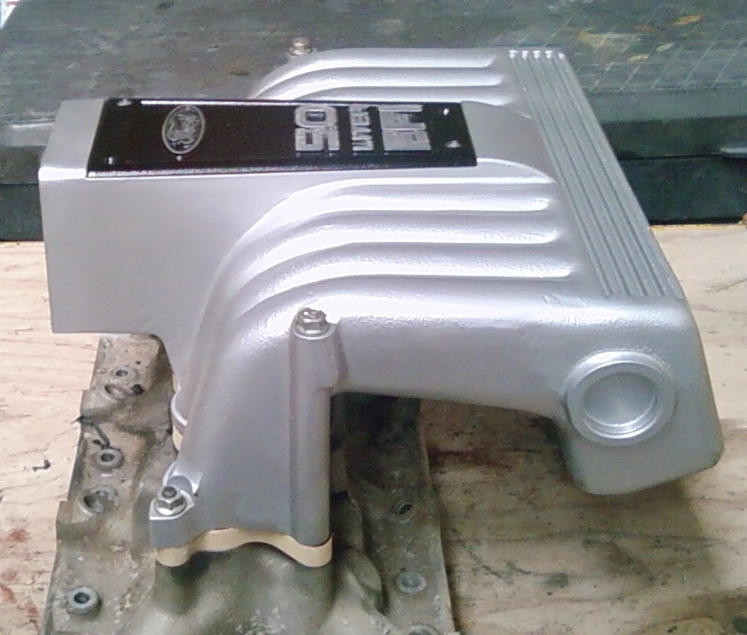

I just did the final cleanup, grinding off some ugly bumps and casting flash, before a nice paint job.
I am on to the lower next.
The other lower that was original to the upper is still on one of our cars, with a Cartech upper.
On that lower I tapped the EGR hole on top and put a pipe plug into it.
On this lower, I am just going to use port blockers at the head, and not worry about blocking the EGR port anywhere else.
The first thing on my list for the lower is drilling and tapping the IAT boss.
I want to have the lower bead blasted for a natural look, but I don't have access to a blaster anymore, so I might just go ahead and paint it. The only problem with that comes when you spill oil or gas on the lower... which will happen sooner or later.

The paint is VHT (or was it Duplicolor? I don't have it in front of me) 500* 'engine paint' in aluminum.
It turned out 10x better than I thought it would. Especially when I was spraying it. The paint came out thin, swirling with different shades of light and dark no matter how much I shook it up, and ran everywhere.
Once it dried though, it was level, consistent color, and seems solid without being 'thick'.
I was impressed. I think I am going to do the lower and valve covers with it.
It was on sale at advance for $5 a can, and it only took 1/2 a can to do the upper.
