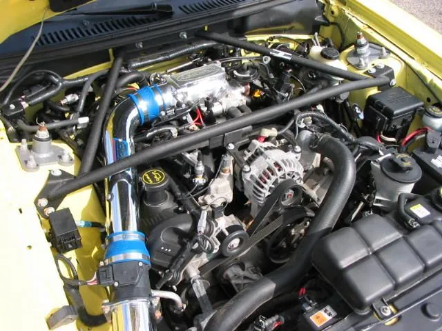

Unfortunately my motor is covered in pollen right now but, this is from the last time I cleaned the motor.
