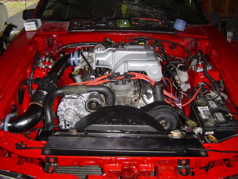

I used purple power on the engine bay, It takes off all the dirt and the paint down to the factory primer. And didn't leave a film or anything, all I had to do was paint after i wash it all down with water.
Then i used dupli-color semi gloss black (same thing I used on the motor) and painted the bay.
