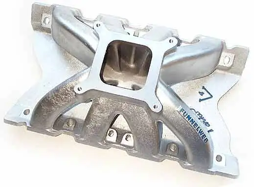

Is this the end all, be all of 351C intakes? The Parker Funnel Web...
http://www.fordmuscle.com/archives/2001/04/funnelweb/index.shtml

From the pic I see the FW has a small plenum compared to the SD. Smaller port runners too. I suppose this would make it milder than the Holley.
IMO it, Funnelweb, looks like a Torker that has a runner cooling valley.
Go to the link in my post with the pic of the funnel web and read about the test. Bigger is not always better. Funnel Web looks better. It has a 35hp advantage on the test engine (Test #2).
