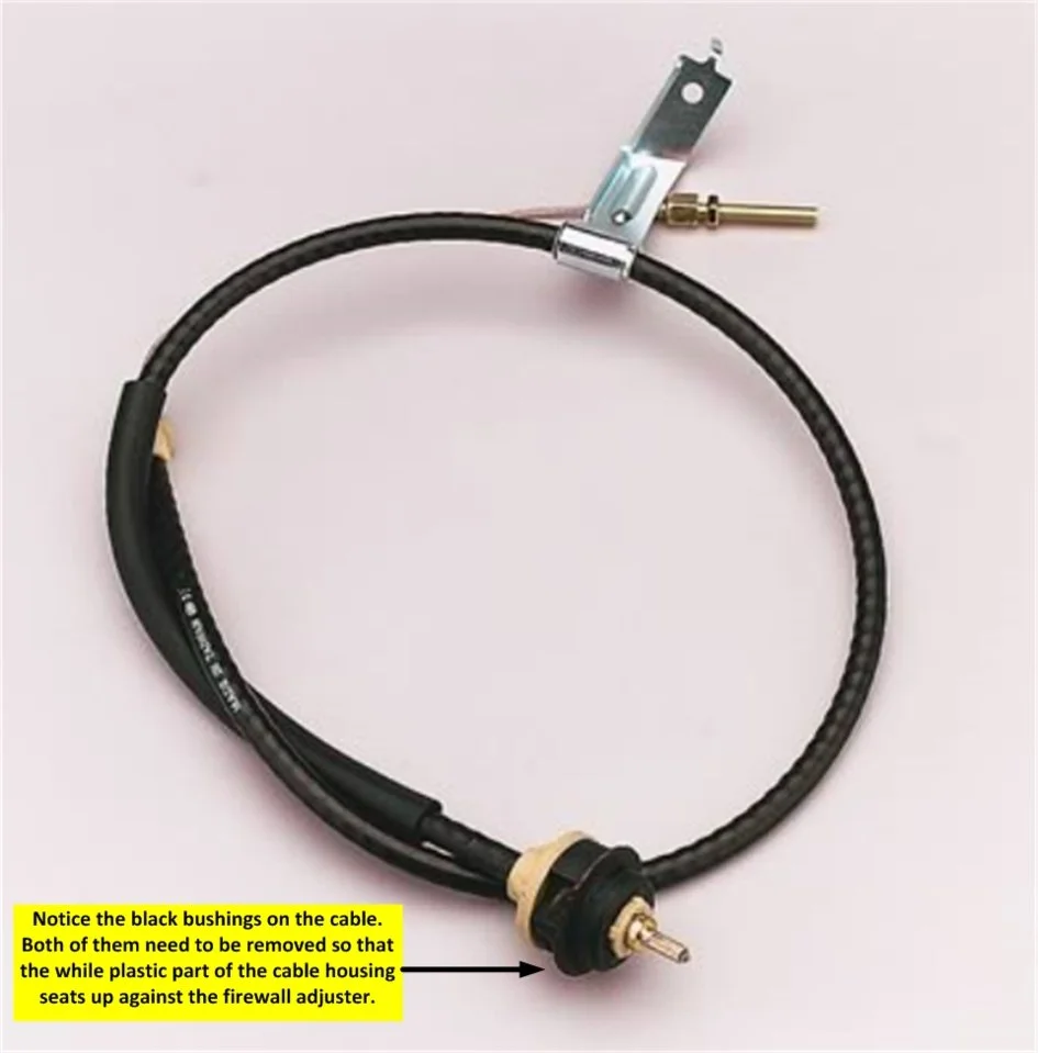

See the picture and comments below for more help...

You said the rubber part is touching the adjuster in one of your posts. The rubber part is to be taken off the cable and the plastic part goes inside the adjuster.
