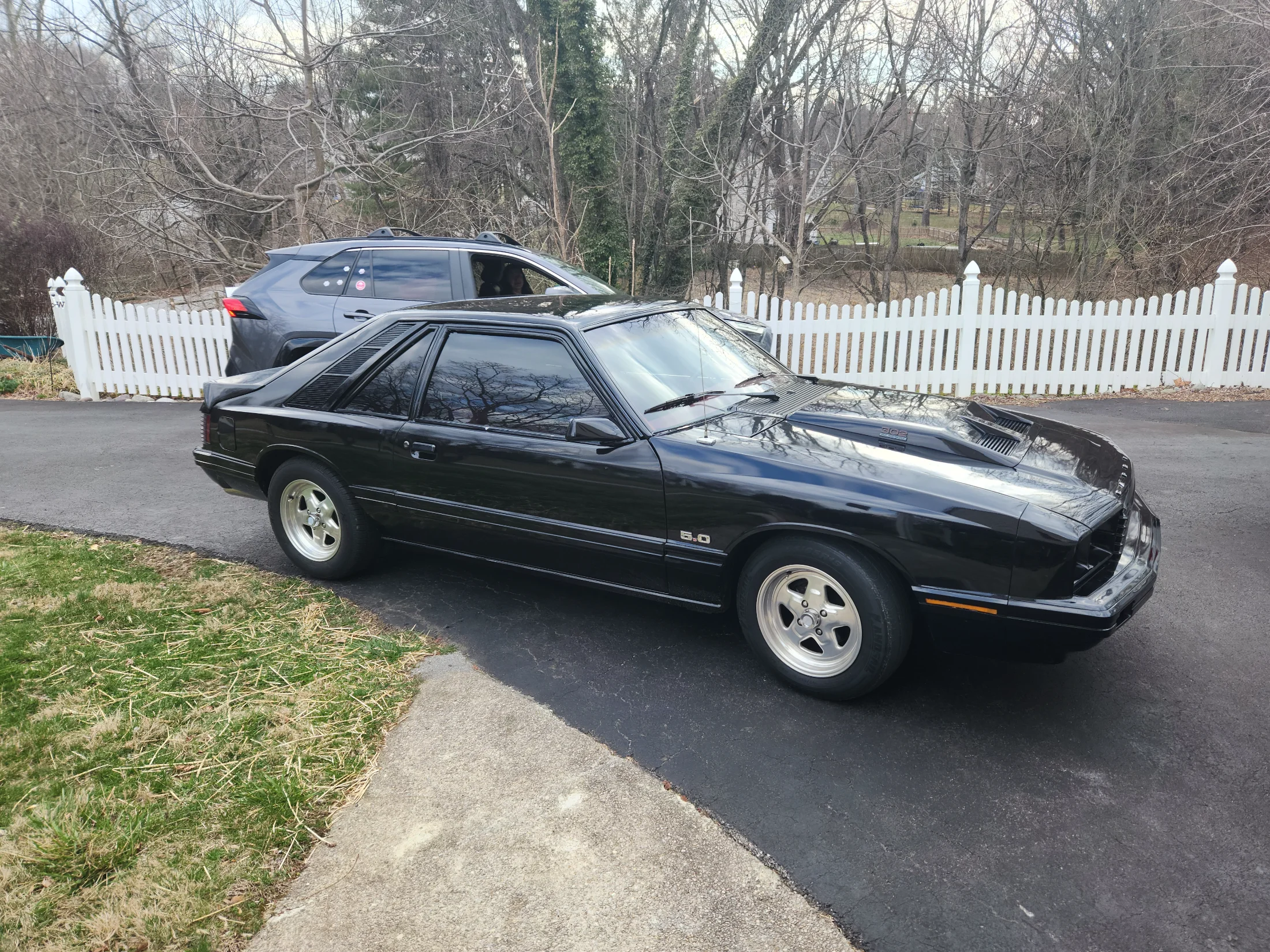

Last weekend I got a clean 82 Capri RS 5.0 with 74k miles and no rust. I'm reliving my youth.
I get a lot of attention from the public, a lot of people have fond memoroes of foxbodies in their histories.

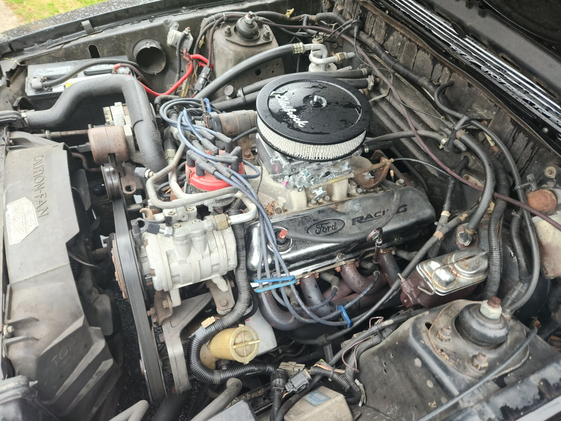

Car has a T5, 8.8 rear with 3.55s, and the motor has a mild cam, shorty headers, EBrock Performer aluminum intake, and Holley Brawler 650 vac secondary.
I'm not planning on doing anything more to the motor other than maybe throttle body FI.
Welcome and we pretty much all like the Capris. There may be a couple that don’t but we can ban them.
That is one clean Capri!!!
