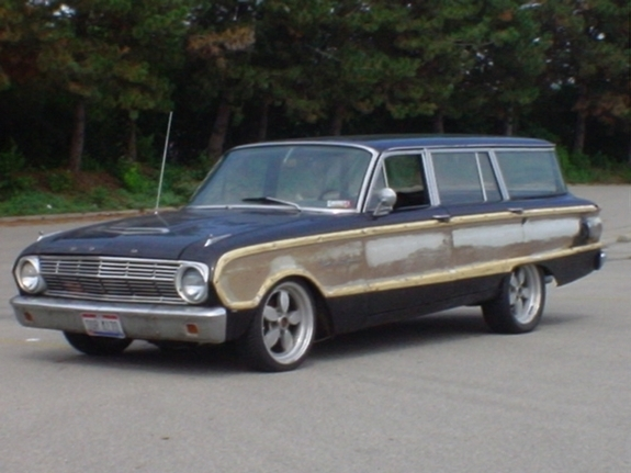

That's factory for 63 Falcon. If you look in the top right corner of the pic there is the end of a Mustang pedal less the pad. I pulled the Falcon pedal but left the pad mounted to the floor.
Falcon pics
