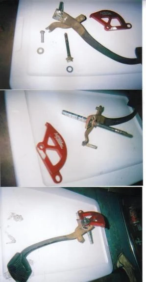

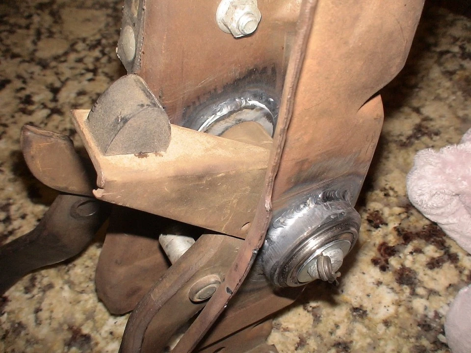

the quadrant can be done, and fabbed up, but don't cheap out if your fabrication skills aren't 100% and wind up with some hokey ****. I went with the mustangsteve quadrant, his fwa, and even his roller bearing assembly and the 96+ cable. In the end, I have less than $300 into it, but that includes the welding work and roller bearing pedal assembly....
the quadrant from mustang steve
and his roller bearing setup
I wanted to do this cheaply but do it right and never have to look back, and I have a real solid setup now

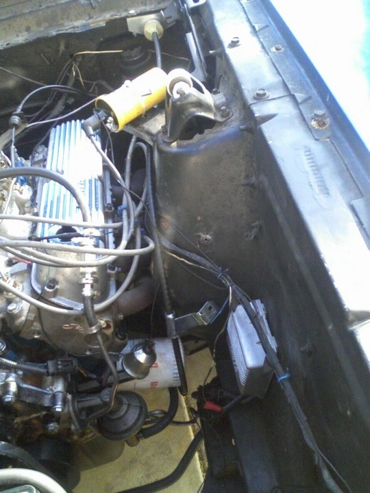

My cable was plenty long enough..I have the 96+ adjustable cable which is a tad longer than the oem non adjustable unit.
plenty of room to not hit anything up top

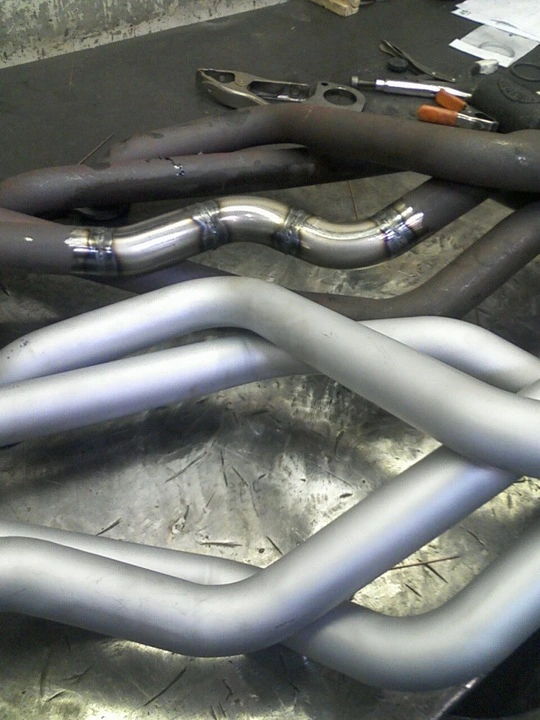

as for the headers...

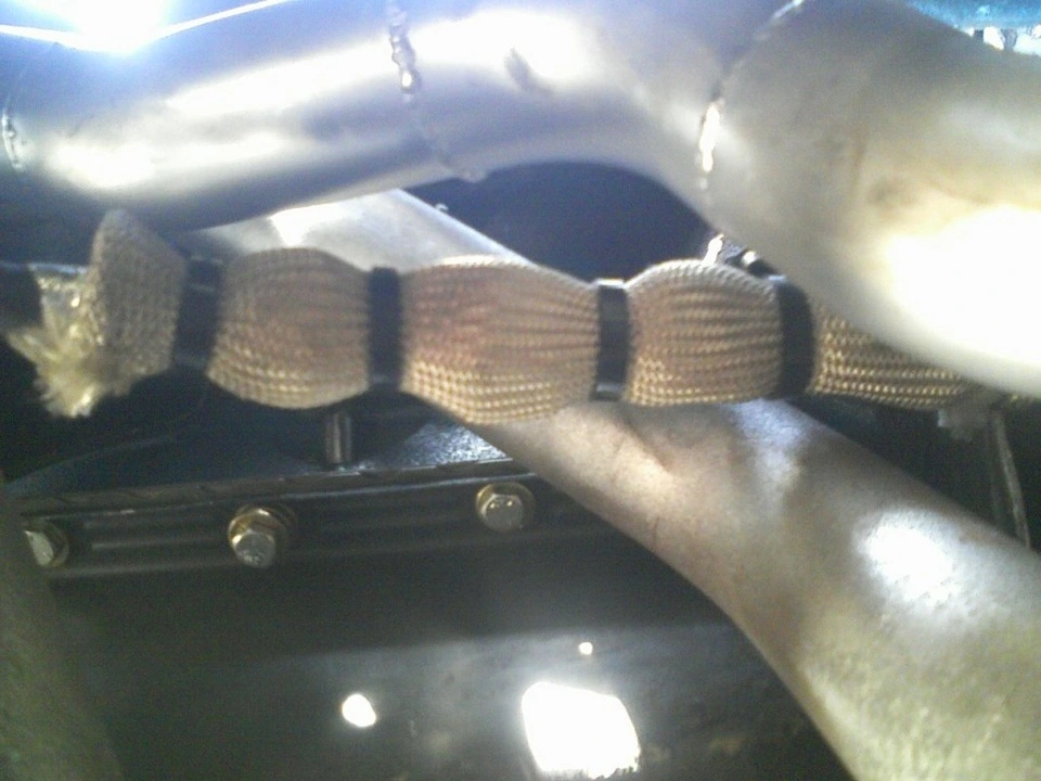

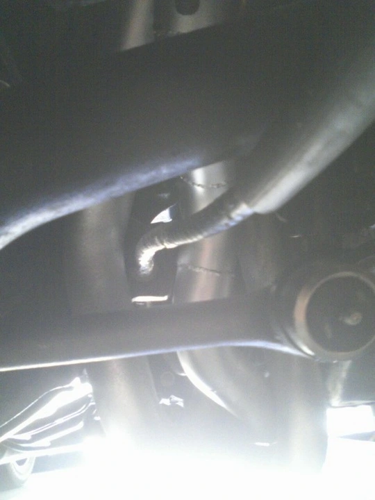

Here are my headers (top) with the modified tube. Below is another set of the exact same headers with a tube that hasn't been relocated yet. Plenty of room to relocate...no drastic moves are necessary...just slight ones
here is a shot installed. I have a direct cable shot in now. I triple layer heat protected the cable....first with heat reflective tape, then with a thick rubber vacuum hose, then with spark plug boot shield. It still doesn't touch. So long as you have an air gap between the header tube and the cable..you can run shielding and be just fine.

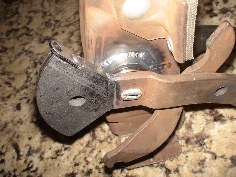

I came up with this mod about 4 years ago to cut costs. I picked up the quadrant local for $20.
I picked up used 96+ cable free take-off free locally, was adjustable.
Mustang steve has an aluminum block that mounts to the firewall flange, this is nice because if you let the end of the cable but up against the hole in the firewall it's enough pressure to punch a bigger hole through the firewall, I did just that.

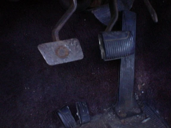

For the pedal, A buddy of mine we took the pivot rod that goes through the center of the brake pedal and welded a junk yard clutch pedal to it. The brake pedal, I cut the pad a little to allow room for the clutch pedal.
This was an auto brake pedal in my falcon cut down
