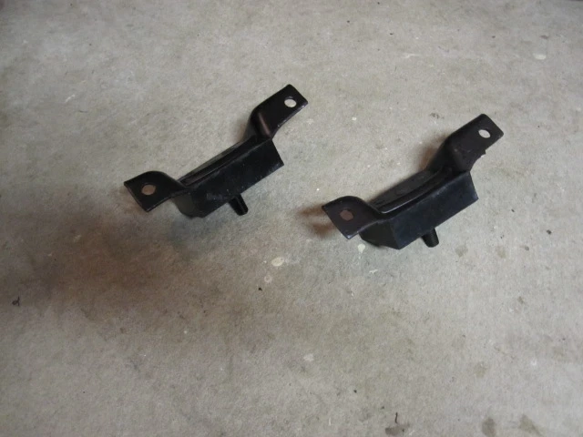

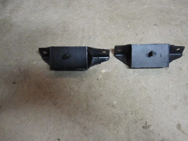

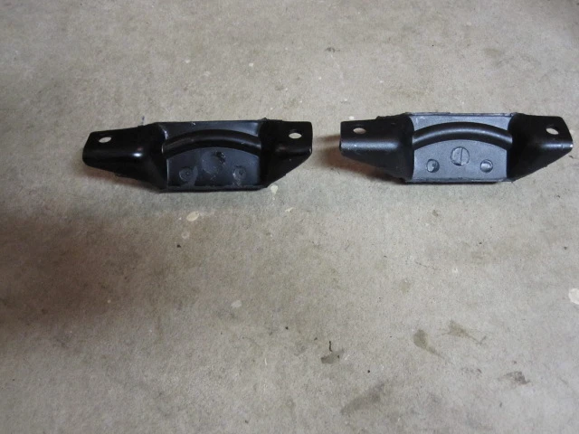

Well, I received the new engine mounts today. So, I guess I will pull the old ones out this weekend. I didn't want to put too many miles on it last Saturday with the chatter. Not that putting on a few extra miles would have changed much. I do like the idea of breaking it in.:D I have a stock bellhousing and the linkage was pretty smooth with no stiff points or binding prior to putting it back together. So, I'll on the new mounts, put some miles on it and see how it goes.
Question on the engine mounts.... Both the left and right mount look identical. They're stamped with a different part number, but they look identical. Is that right?

Here are some pictures of the new mounts I received today.
