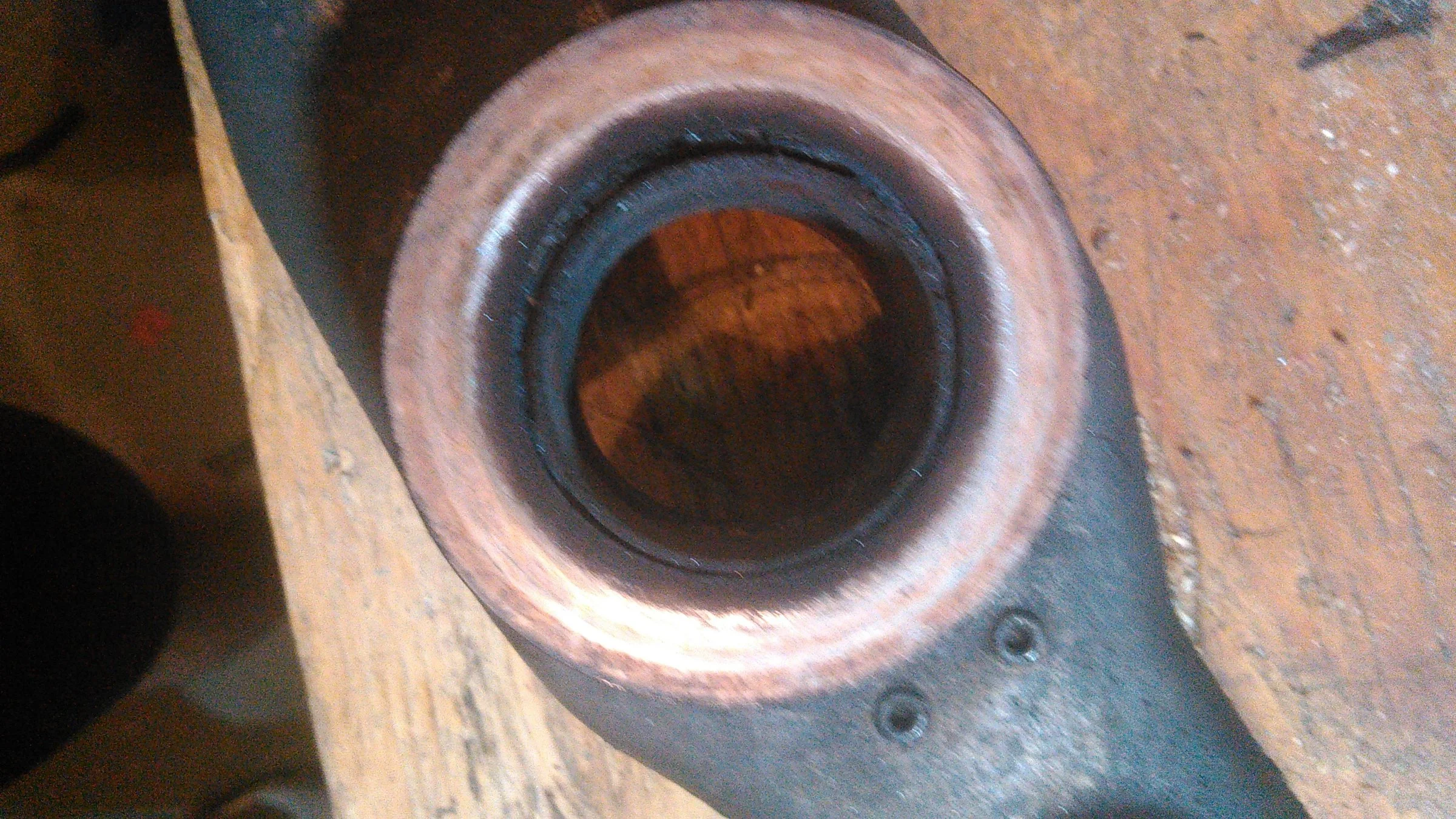

Inner race isn't centered, sounds like craps when I spin it.
