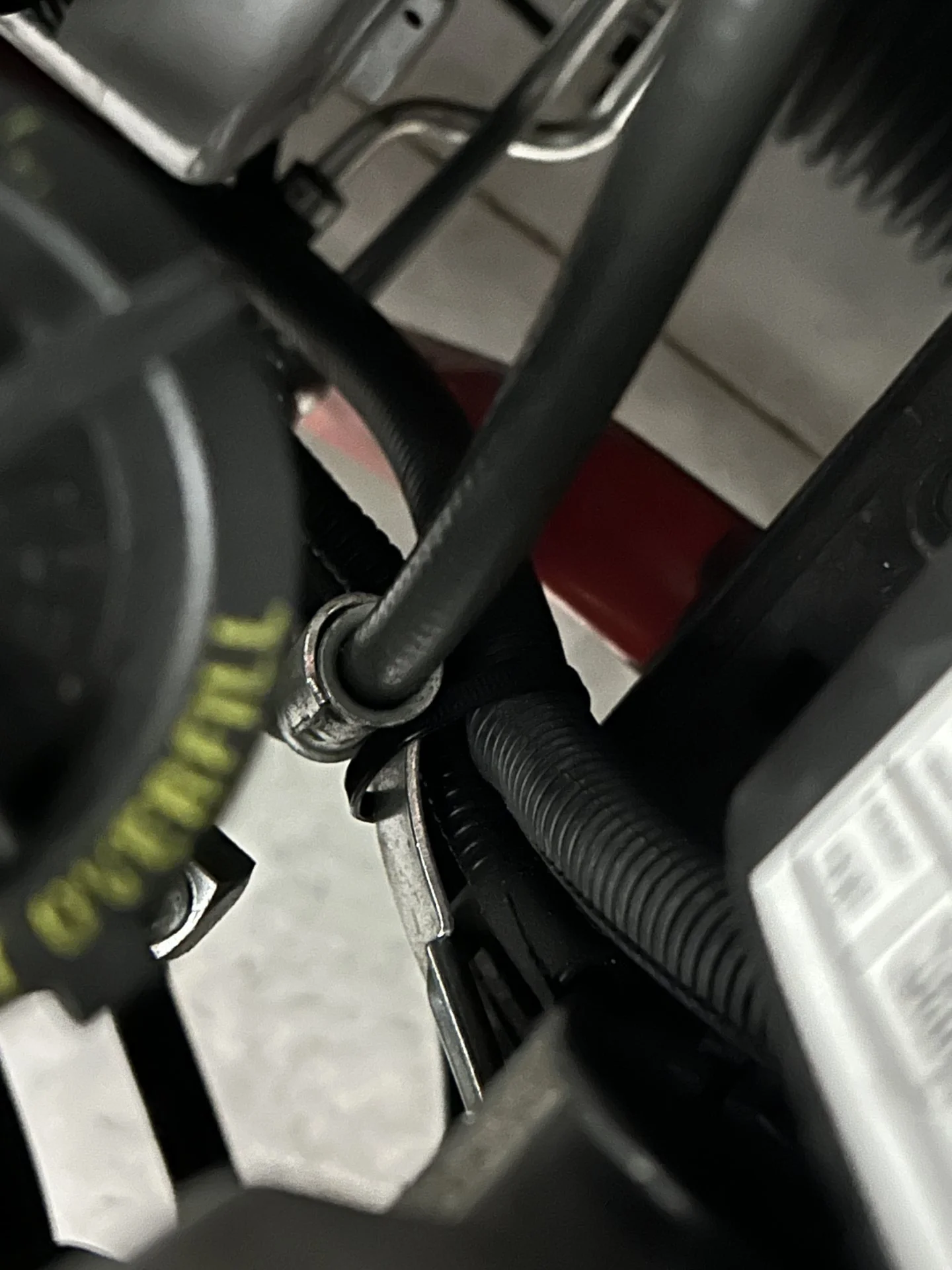

I routed mine as close to stock as possible and found a place on the frame rail to bolt it to. This picture isn’t the best but maybe it will help.

Any chance some of you are bored and can send me a few more pics of clutch cable routing??
It looks like the stock cable came off the firewall then the bracket bolted to the drivers side frame then curled back to the clutch fork..
I have read where the longer MM one goes clear around then down under the engine mount as it snakes back to the clutch fork
My biggest concerns are where the cable runs in reference to the exhausts.... I have shorty headers...
Thanks
