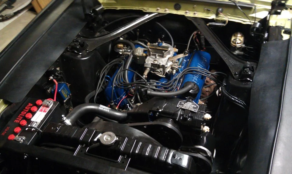

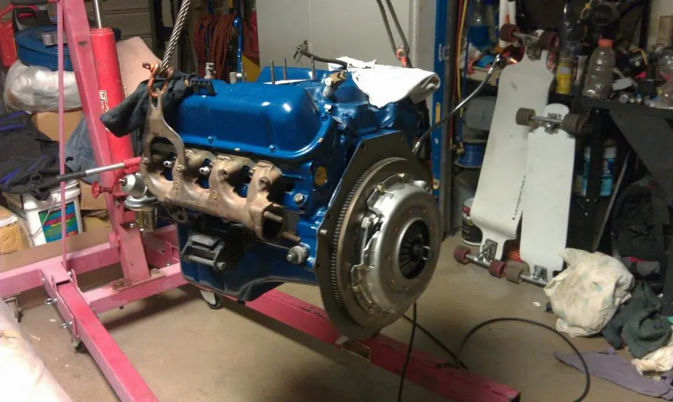

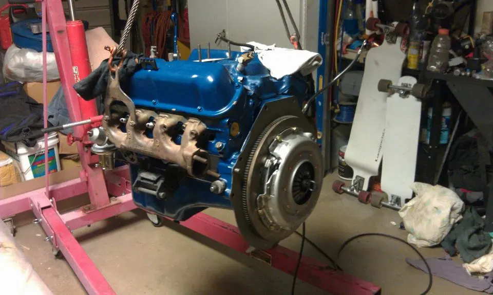

I just rebuilt the 302 in our 69 mustang that had sat for 20 years. Replaced the clutch and now the clutch pedal wants to jump half way through release. This causes a very jumpy take off. It just wont release smooth and easy. Ever seen this before? Any ideas what I did wrong?

Lotsa possibilities, starting with incorrect adjustment of the linkage, incrooect-sized release bearing hanging up, trashed bushings on the pedal, etc. First up I see you've used a diaphragm pressure plate instead of the OEM semi-centrifugal pressure plate. These are very different, and often the diaphragm type requires (and delivers) less pressure.

All of the bushings are new and in the right place. Motor mounts and trans mount are new and secure. I wanted to reuse the old pressure plate, but couldn't find just the disk for sale anywhere :mad: so since I had to buy it I figured I would use it. I didn't know it was not as good as the original :shrug: The pedal actually feels really stiff on the release (before to the jump), and really weak after the jump. What do you think that means?

There is a spring on the clutch pedal assembly. It is both a return and assist spring for use with the old 3 prong style pressure plates. It should be removed when using a new diaphragm pressure plate. Might solve your problem. The diaphragm pressure plate should require less foot pressure to release it and clamps the clutch more uniformly. It is better that the original.

Not necessarily better or worse, since those are value judgements. Different, though. I like the semi-centrifugal, they grip tighter as rpm increases. The diaphragm does not. The diaphragm requires less pressure to operate, so it's easier on the leg in daily driving.
2+2 hit it. As soon as I saw that clutch, I knew it was a diaphram instead of the original style 3 finger.

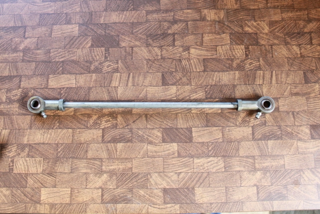

i have been using this for some time now,replace the rod from the pedal to the z bar with a 3/8 rod threaded at both ends with 3/8 spherical heim joint ends on both ends
this will remove any friction or binding that may be occurring the pedal will feel much smoother and easier to push,this will work at the rod for the throw out arm as well . i saw a kit for this but i cant rember who had it ,but you can make it your selfe
