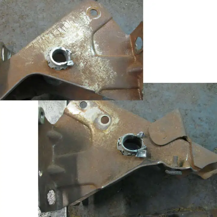

It's entirely possible that the pedal support is badly worn, and not only does this cause additional friction, the alteration in geometry can make the pedal effort excessive. Last summer I repaired a bad pedal support in a 69 428. Prior to the repair, just moving the car around very nearly required using both feet on the clutch. I pulled the pedal support, and threw it away. I put a Drake bearing kit on (which is a pain, I had to grind down the washers to get the clips on) a used pedal bracket, and a new shaft, which was trashed.
Carefully adjusted to spec, didn't even replace the equalizer bushings.
Anyway, after that repair, any 12-year-old girl could have pushed the clutch in. Not bad for a 428 Cobra Jet.
It looked bad, and worked bad. Amazing how much pressure resulted from the slight change in geometry due to the damage:
