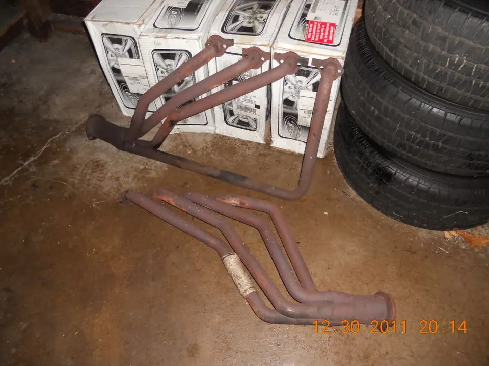

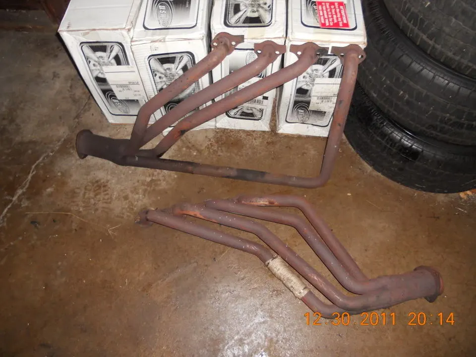

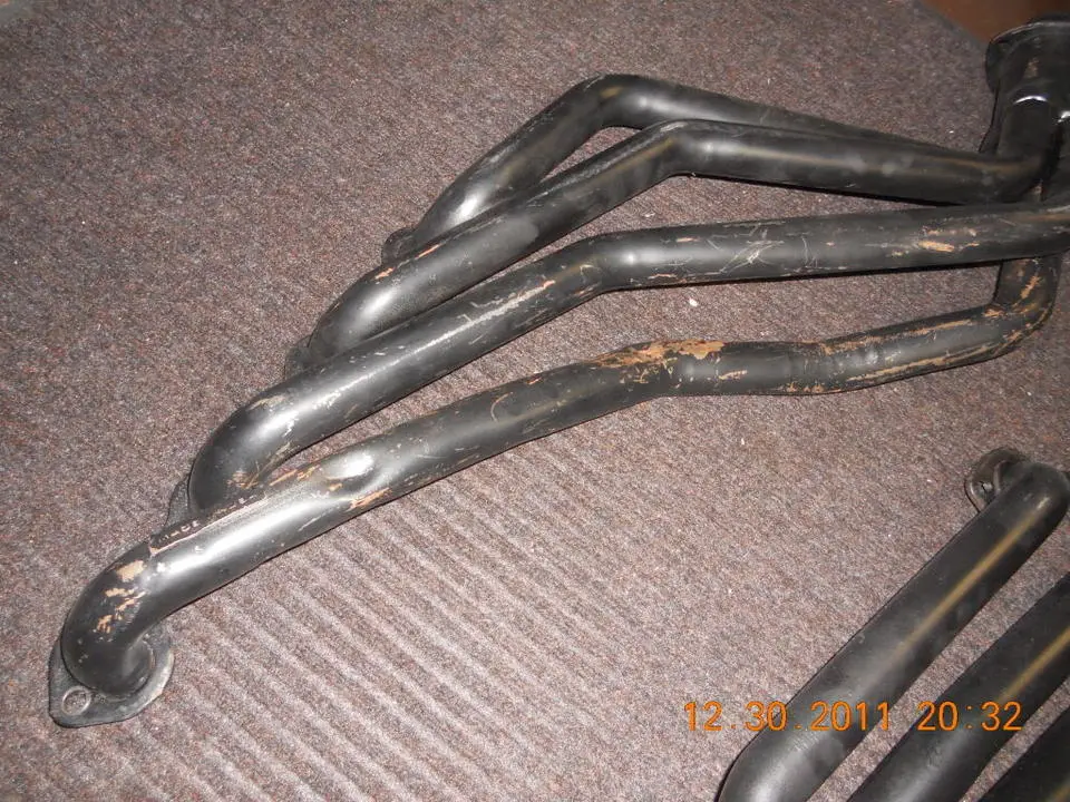

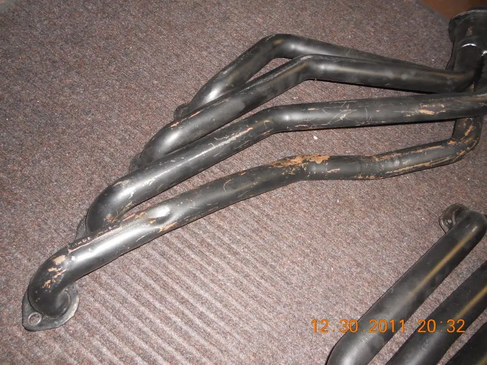

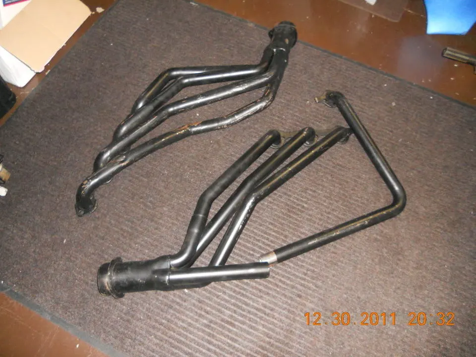

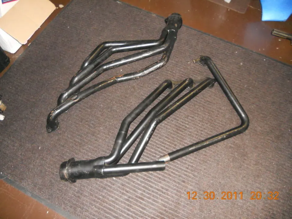

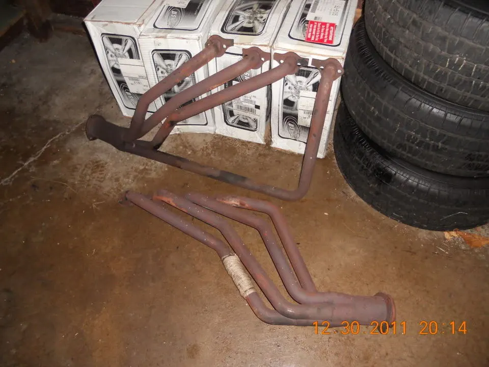

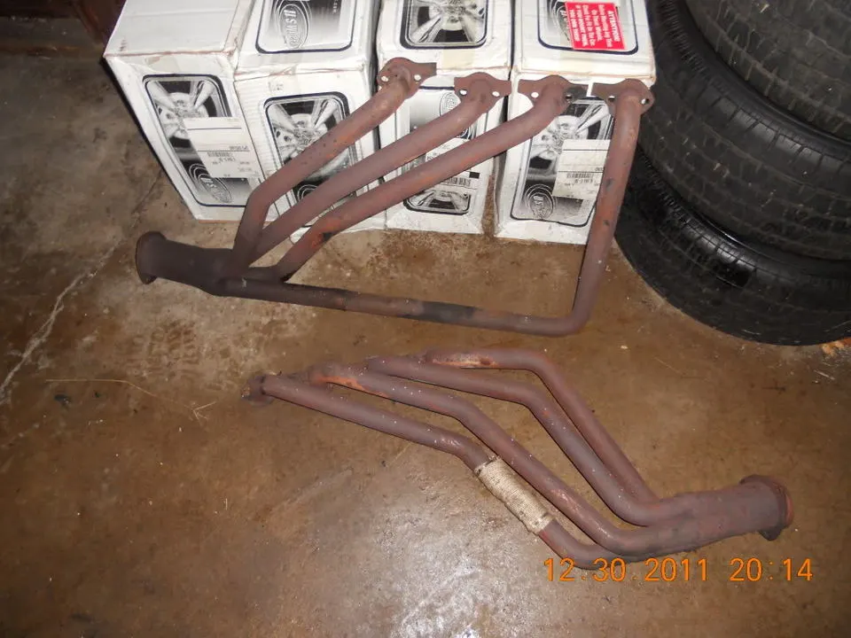

I had the same trouble on mine fox bell housing and trans. I used hedman headers and I had to shorten the clutch fork. It did work but the clutch cable did end up resting on one of the header tubes I had to wrap both with heat wrap never did have trouble with it. I do have two pair of hedmans if you are interested new and old. The new ones left, one of the tubes is beat up good. I was trying to make it fit better with the cable and new blowproof bellhousing. They are a good start to cut into 100 plus shipping was what I was looking for. Or you could go custom headers but thats big bucks. Here are some pics.

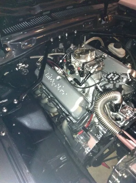

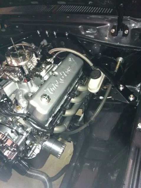

I have a 347 with a t-5 as well and I started with the block hugger headers and had to give that up after a lot of work. I went with the headmen long tubes that are in the photo above but had some custom bends to miss the clutch fork. I also had it split so tubes will come out single. The passage side header will break down into three pieces and driver breaks down into two. Sure helps with getting them in and out.

I live in Oak Lawn IL. I would say between the two you can make a nice set for your car. I can look too see if I have that clutch fork laying around also, its hack but it worked for 8 years.
