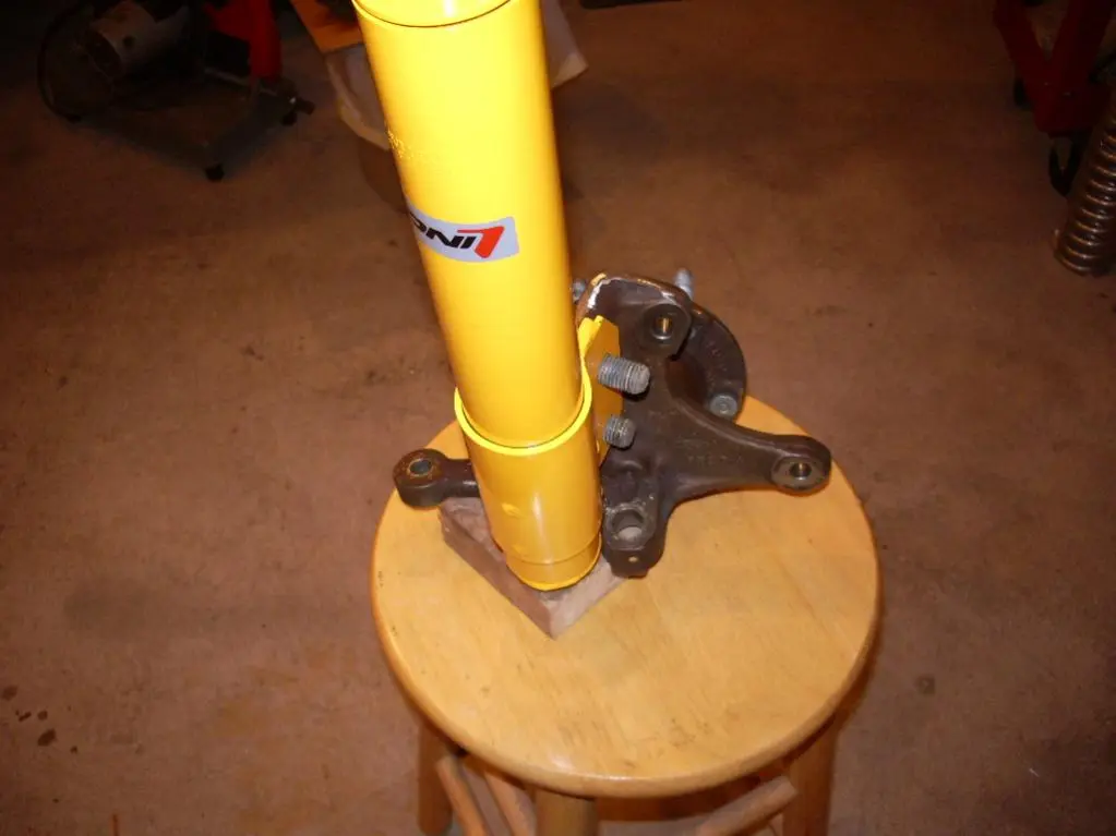

This is my 96' spindle with a strut attached.
The two holes in the spindle are for the caliper, which bolts directly to it.
The difference between the 95' and earlier spindles are about 3/10" in track width. Everything else remains close to identical.
I will double check my junk for a bracket, but I just tore mine down so I can mock up my suspension and check geometry.
I do of course have the 13" rotors and PBR Cobra calipers (38mm cups)

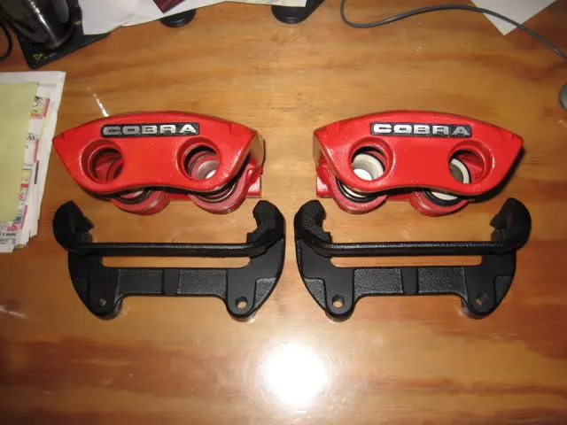

The bracket is part of the caliper. If you buy new or used calipers they usually come with them
This bracket is what bolts directly to the spindle. There is no other bracket. If you are missing this U-shaped bracket, you'll have to go to Ford or look around for someone selling a used set without the caliers. These are usually sold together as a pair

Well, like i said, it's usually sold with the caliper. If you buy a pair of calipers new, or remans from Autozone, you get both parts. Then you just bolt it to the spindle.
It's not typical to sell or buy them without the brackets since it is part of the caliper, and the cost of buying the brackets new can drive the cost up to the point where it would have been cheaper to purchase the calipers as new loaded units especially when you factor in pads and the required hardware kit with the pins and anti-rattle clips.

bevers7748 JamesD on this site has a set of brackets for sale. I know him from another forum. If you want I can send him a message if your interested.
I just picked up my Cobra calipers from Advance today. They can't get the brackets and Ford wants $122 each for the brackets.
