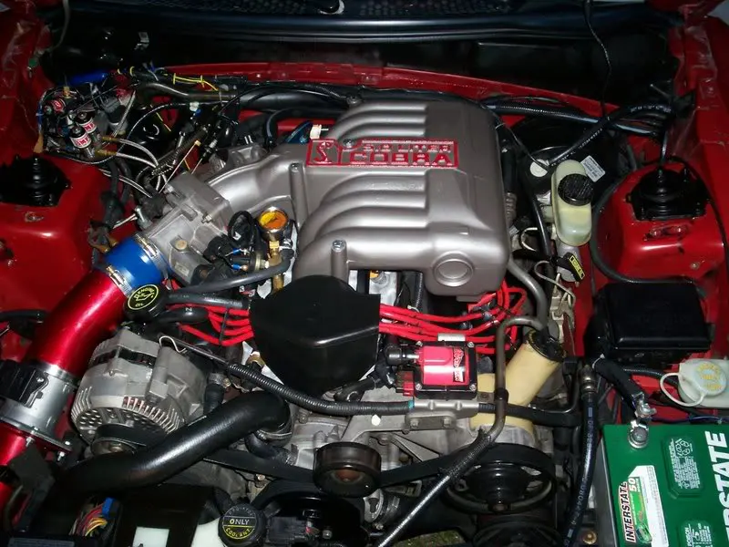

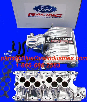

yes it will fit but you will need to purchase an Intake Elbow Adapter
intake manifold,,right...the Intake Elbow Adapter is needed in the 94-95 models notice in the foxbody cobra intake, it has no curve to it as needed in the 94-95 models. the adapter allows us to run the foxbody cobra intake.
this is a foxbody cobra intake notice no curve at intake as needed by the 94-95 models..
