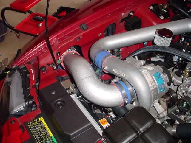

My pipe was one of the early ones. It seems like the new ones are two piece where as mine is in one piece. Mine is about two inches short of reaching the mounting bolts on the inside of the fender. I agree that if it was mounted to the fender it would have no give to it as the engine moves and could cause some damage maybe???? I thought about cutting mine and adding a piece of hose, but instead i split a piece of 3/4" heater hose and lined the opening in the fender and just left the MAF unbolted from the fender. I have had no problems with it this way, causes no damage or noise. Here's a couple of pics:
