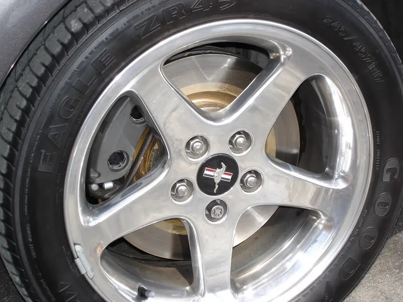

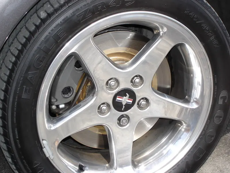

I just did the install last week. The thing I noticed is that in regular driving they feel EXACTLY the same to the stockers. It's when you really get on the brakes that you feel a BIG diffrence. Worth every penny IMO.

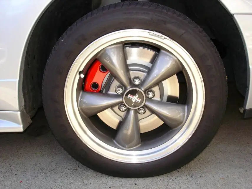

I love my Mach 1 brakes. I bought the buyfordracing.com kit which was two loaded calipers, two plain-faced Brembo rotors and a set of stainless steel brake lines for $310.
One thing i didn't like was the black color of the Mach 1 calipers, so i painted them red using the duplicolor brush-on kit. Looks like bullitt calipers minus the pony. I beleive there are white pony decals i could buy and put on if i really wanted...but i don't. I also painted the hats of the rotors silver to prevent rust and also to match the car
