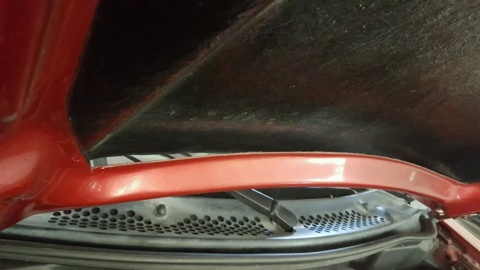

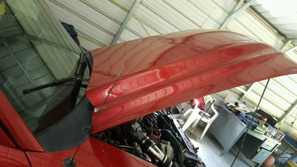

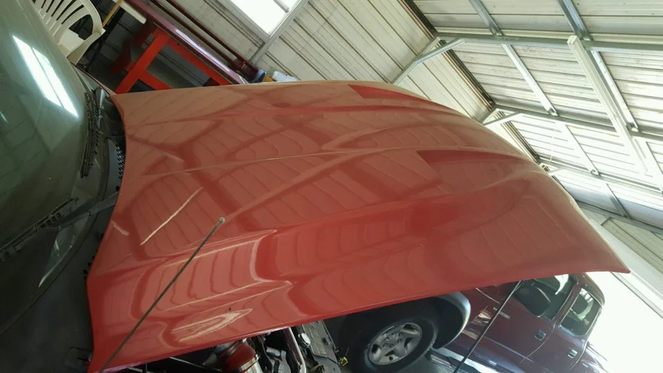

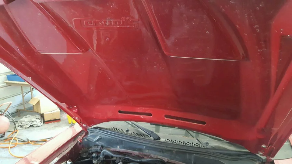

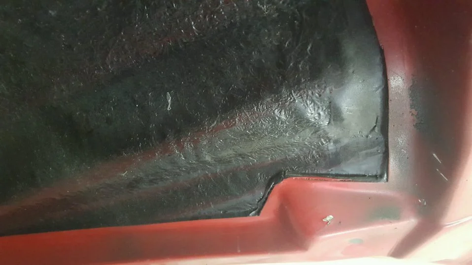

I bought a 95 and the hood shakes while driving. I haven't driven it much since I bought it a few months ago and I'm thinking the shake is more so at speeds of around 55-60 as I cruised bring it home on the little over 3 hr drive. The noticable shake is also at the very top middle of the hood, where the hood begins in the middle of the cowl as you are looking at it while driving. I googled something about pins and read a few things about some guys having/wanting to use pins with fiberglass hoods. I just wanted to see what you guys thoughts were about the matter and rather my hood is a product of it being light (lighter than my cervini's stalker hood)?
Not sure rather some aftermarket hoods are made lighter or not. My cervini's is fiberglass as well but it's heavier than that cobra R hood. Also and I have to double check, but it appears that the previous owner or one of the owners put some black , a black liquid thick glue-like substance on the pass side part of the hood where it secures to the bracket. That may have something to do with it as well.
Ok I stopped when I typed the last sentence to go check the brackets. On the side where the black epoxy looking stuff was used, the bracket where the bracket from the body of the car attaches to the end bracket of the hood, it wasn't torqued. I torqued it down definitely got some good turns on it so from that aspect of it it's much much better secured. I probably won't get to drive the car till I take it in a few days to get the header gasket on driver's side changed. I'll see it if still shakes. I did notice also and there are some images below. It appears they had the center section of the hood cut out. Not sure if it was bought from someone like that already or what. Maybe the car had a different motor in the car and the 302 was just put in or back in to sell it, not sure. Anyway maybe if it still shakes some, maybe the hood is more flimsy and lighter than it would have been had it not been cut out? I like my cervini's hood and also like the Cobra R as well. If my other 95 sells ( wrecked) then I guess I may leave the cervini's on there though I'd like to keep it if I can and may just give a discount off the car minus the hood. I may need the Cobra R if I have intake clearance issues when I do my 351 so will just have to see. Anyway let me know what ya guys think.

I had a 97 with that cobra r hood and it was solid as a rock, but it didn't have all of that mat'l cut out either. The loose bolts may have come from the vibration caused by the structure of the hood being cut away. If the bolts back out again, try some blue loctite. That should keep them put.

What I didn't see was whether or not a SN 95 car has hood insulator bushings like every car I've ever seen. Does your car have the 4 rubber bushings that line the top of the fenders still in place? I'd guess that if they were originally there the PO removed them to get the hood to sit better. W/O those things in place, any hood including the factory steel one will shake back and forth at speed.

The problem is two reasons really. Weight, and height.
These lights hoods just really don't have a lot of mass, so any movement in the hinges or latch will also easily move the hood because it's so light. So any vibrations from the front suspension transfer up to the hinges on that side and into the hood.
Also, the higher the hood, the greater the effect just because of the distance from the axis of rotation. What you'd barely notice on a low, stock hood, now is 1/2" of movement when the hood is 3" tall.
Since there is no "beefy hinge" and latch option, not much you can do really. Lightweight, tall hoods are gonna shake. You're only hope it to try and restrict it with pins or trying to tighten up the hinges from side to side movement. Unfortunately..they are pretty wobbly
