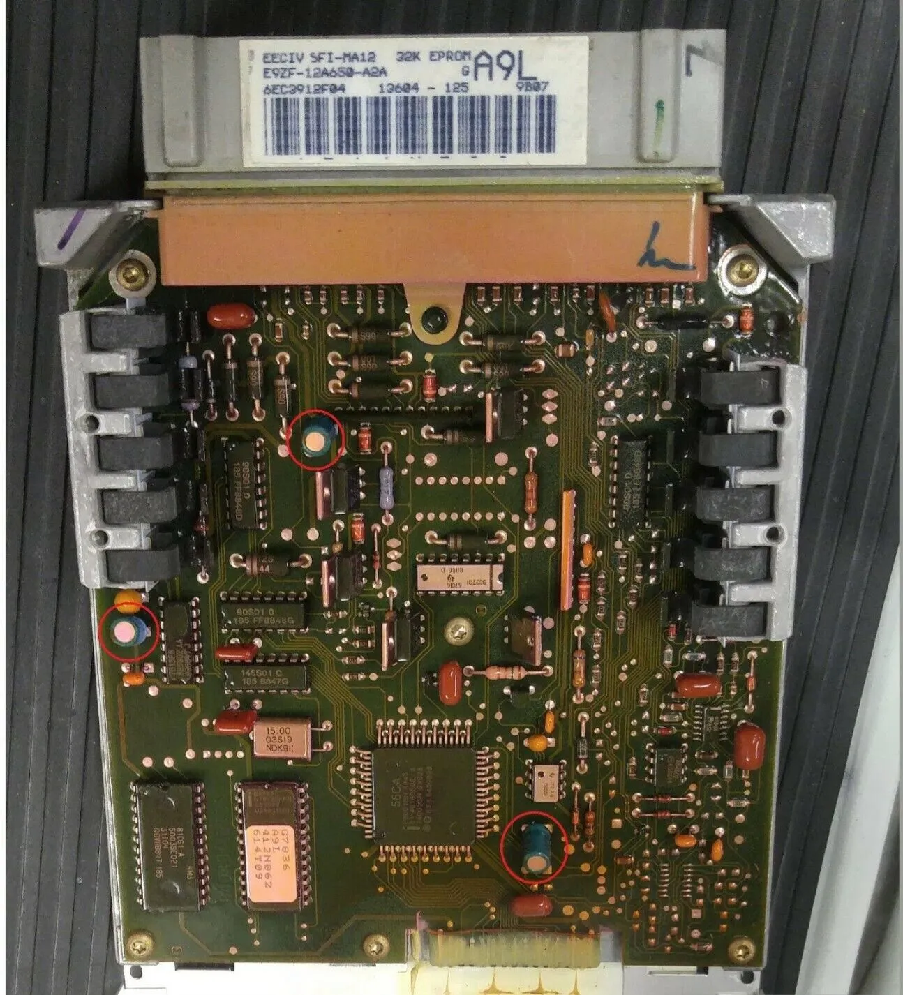

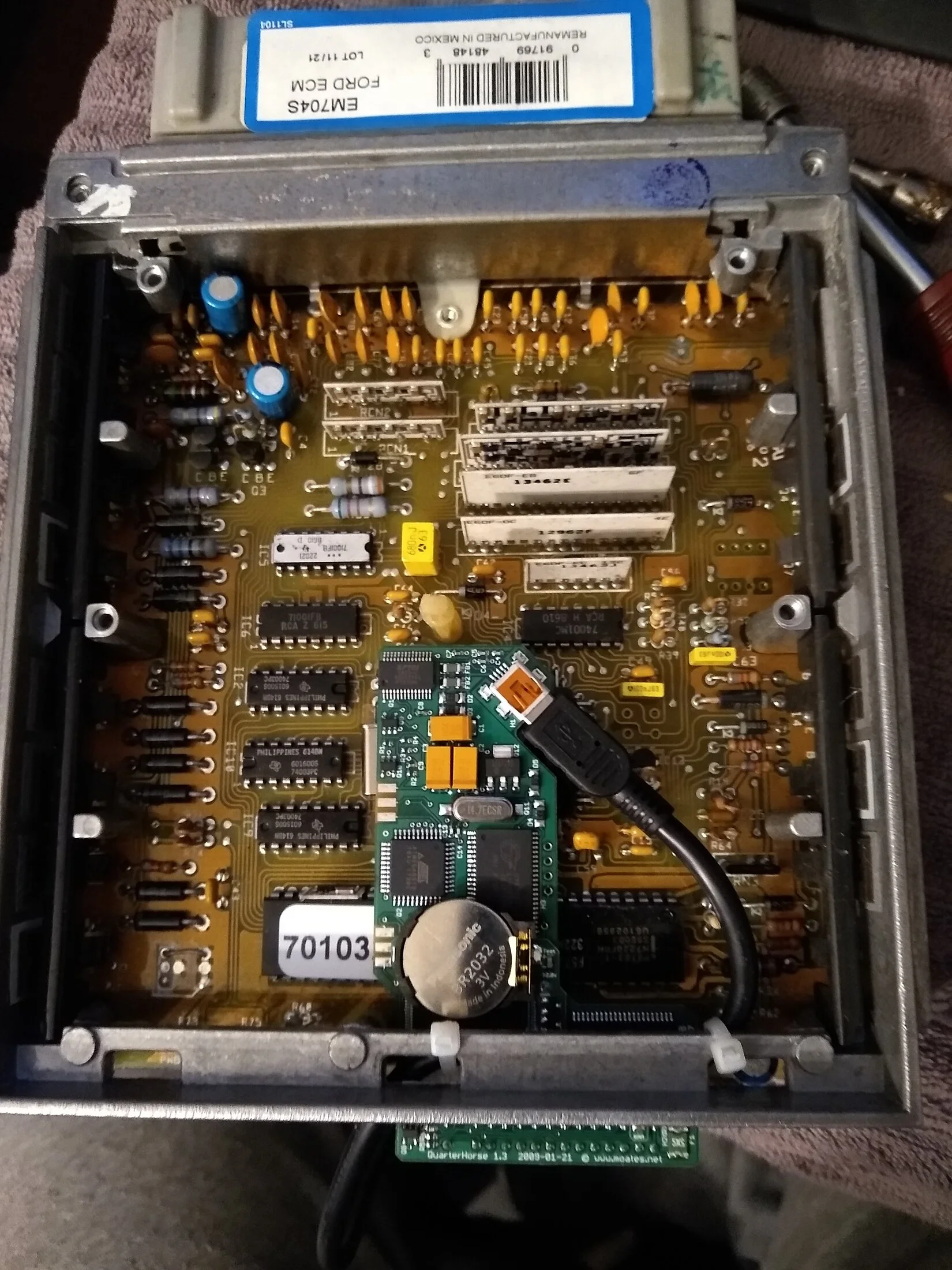

On the California emission Mustang I bought a few years back it had an 8LD computer which is very very strict on the tune but those MAF retrofit kits they sold used an A9S/A9M computer which will cause you to possibly never pass smog if everything including the lil doohickie on the EGR isnt working properly or the diaphragm is leaking vacuum also your fuel injector pattern flow needs to be good....
8LD vs A9L

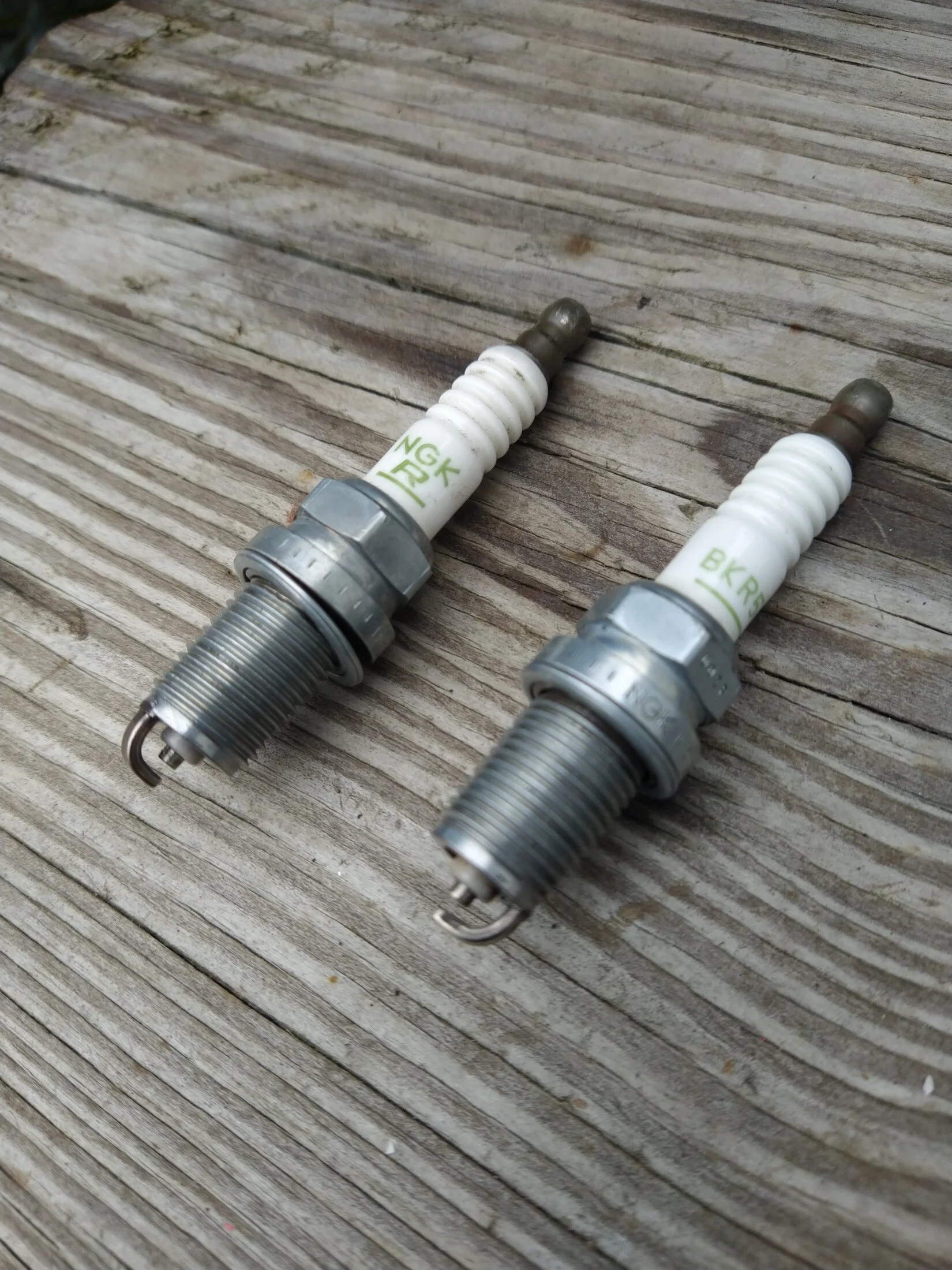

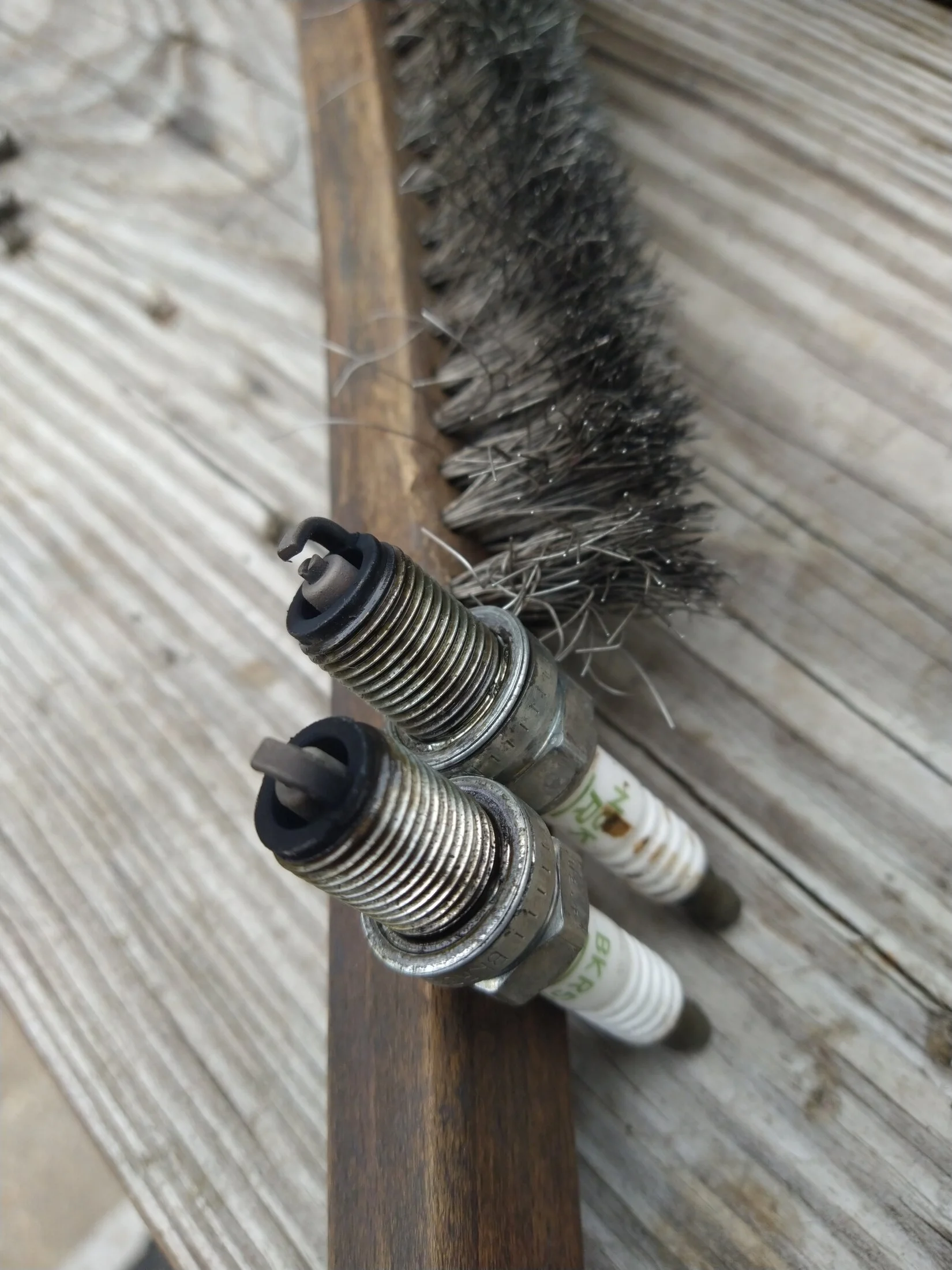

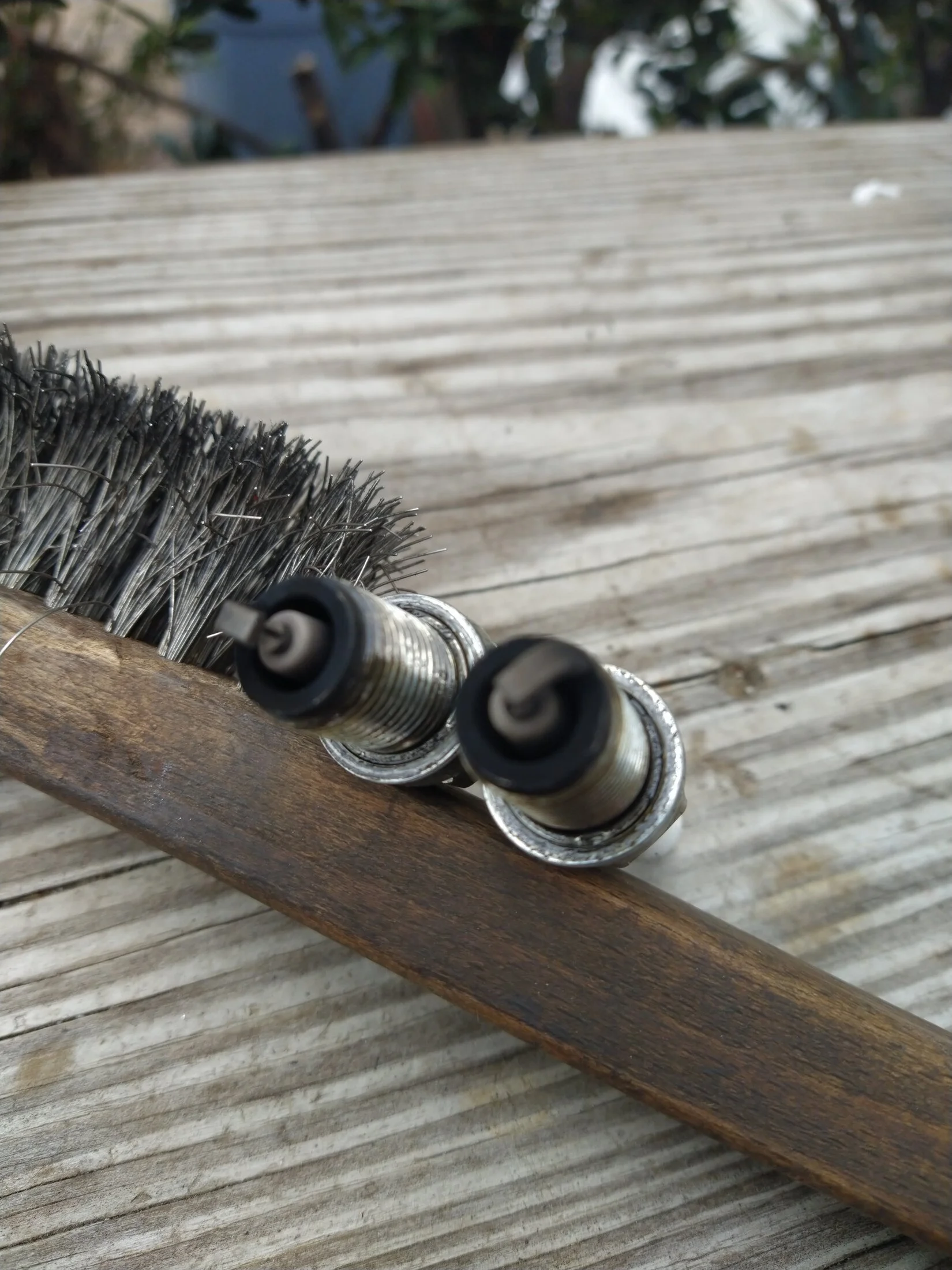

What I do is remove all my 02 sensors and dip the tips in Lemon Juice until all the carbon is gone which takes maybe 20 minutes then I rinse with rubbing alcohol and let dry out......The same method works for sparkplugs too but may need a follow up with a wirebrush. or a toothbrush...
All the lil things add up big when it comes to the overall running condition when it comes to a smog exam..

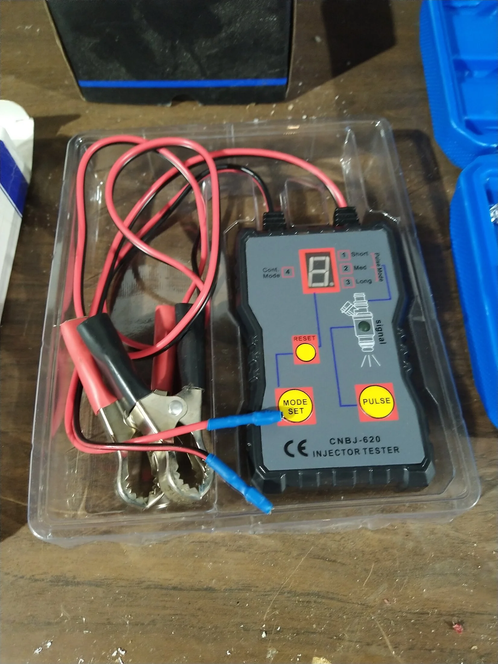

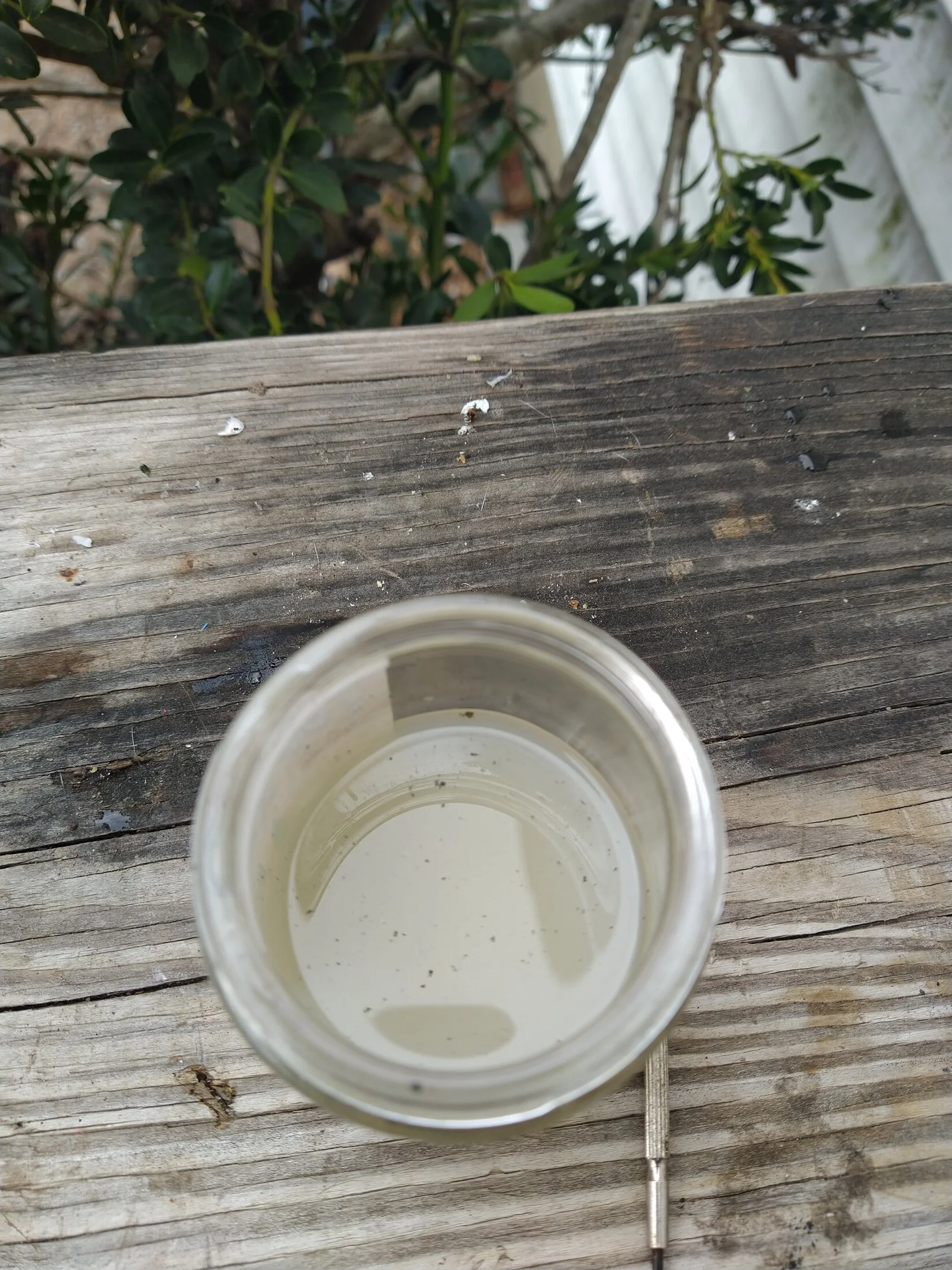

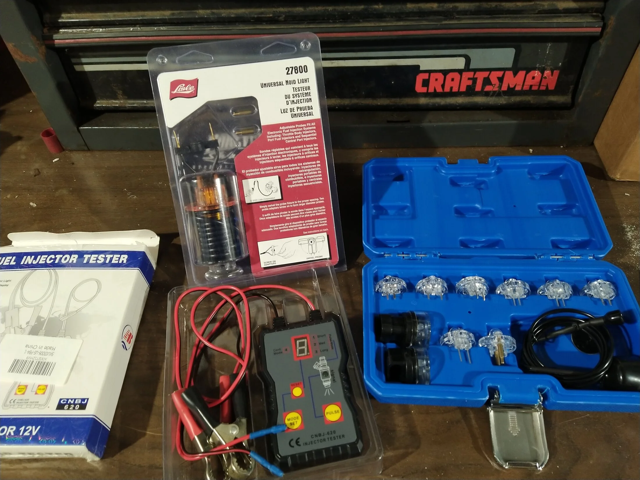

I remove the injectors pull the screen baskets out with a screw and soak them in a mixture of Mineral spirits and transmission fluid and buzz them with a fuel injector tester tool while submerged and after they all pan out flow wise using cleaner and a can adapter for fuel injectors I reinstall them rest assured theyre good or you can buy a new set of 19lb injectors off of ebay for like $30 bux for 8 versing paying $25 for the o-rings , pintlecaps and basket screen kit and actually save yourself some money.

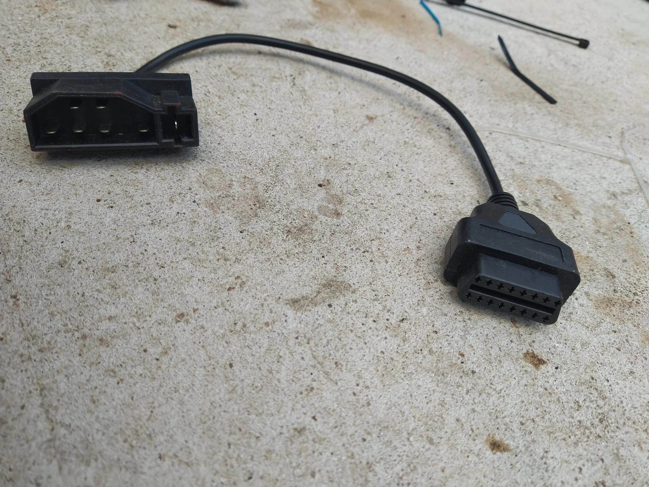

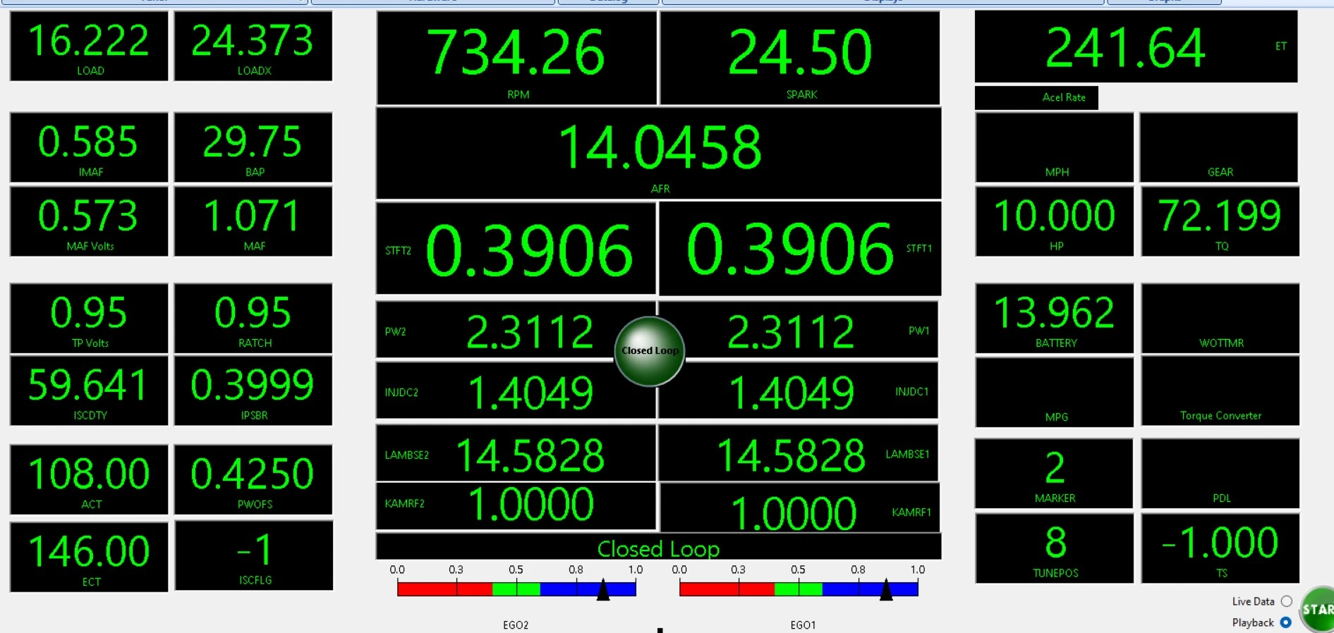

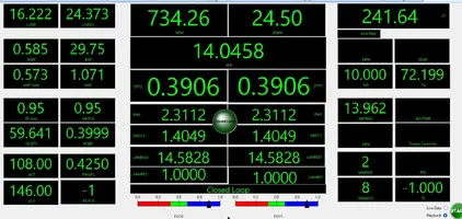

Having one of these $8 wires from ebay and an OBD2 handheld is an awesome thing to have when you can read the engine stats as it runs and know what sensors dont comply...

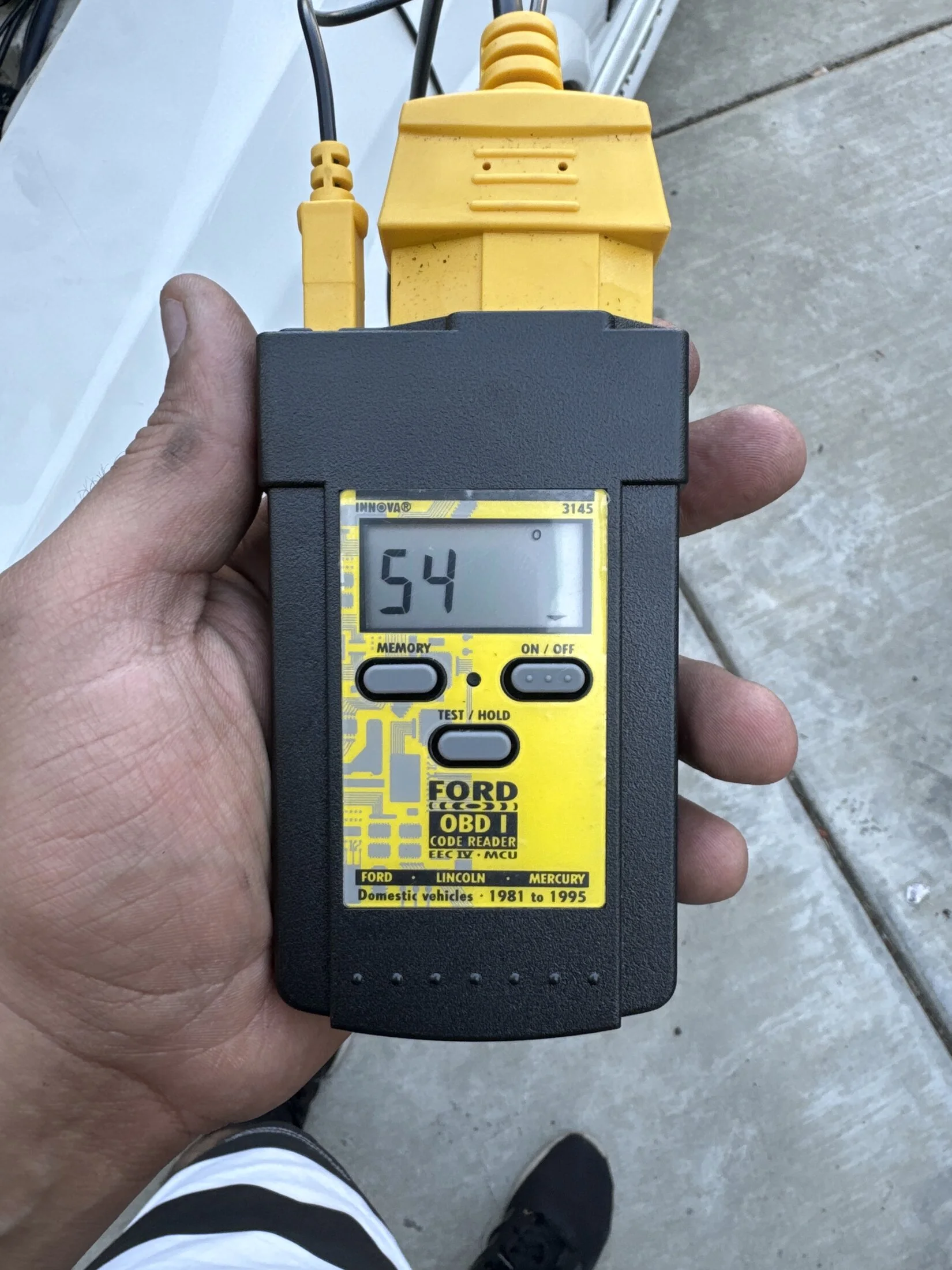

Well it took my a while to get it done busy with work. Code 22 cleared after removing the vacuum line and plugging the other end.
Thank you guys for the tips!

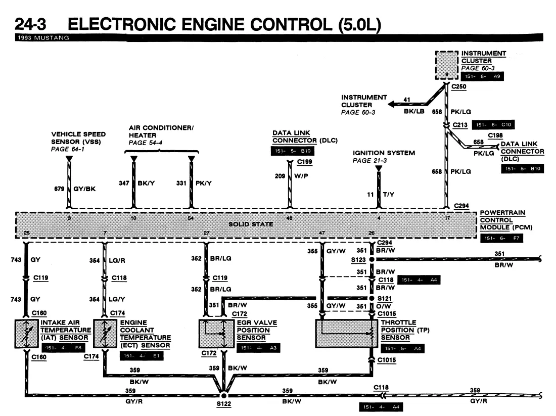

Now I just have to deal with code 54 which is the intake air charge temp sensor out of range or circuit on. I have the sensor which I can replace but does anyone have any other tips? Maybe something that worked in the past ?
Thanks again guys!
Before you parts swap (which you can certainly do if you don't care about the $$), i'd test the ACT sensor itself and the wiring. Code 54 means that either the sensor is broken and open, or the wiring is broken and open.
To test the sensor, unplug it and measure the resistance across the terminals. If the engine is cold, the sensor should read ambient temp, which is somewhere in here
50 degrees F = 58.75 K ohms
68 degrees F = 37.30 K ohms
86 degrees F = 27.27 K ohms
104 degrees F = 16.15 K ohms
If you get what you expect, the sensor is fine. Move onto the wiring.
IAT in 1993 should have a gray/red wire and a gray wire. The gray/red is ground and connects (off-page) to sensor ground which is pin 46. If you measure voltage to ground on the pin 25 wire (gray) you should have voltage there. I think it's 5V but you should read voltage to ground. Or, you can turn the car off and just test continuity from that wire to pin 25. That indicates the circuit is connected to the ECU. The other wire should have continuity to ground.
