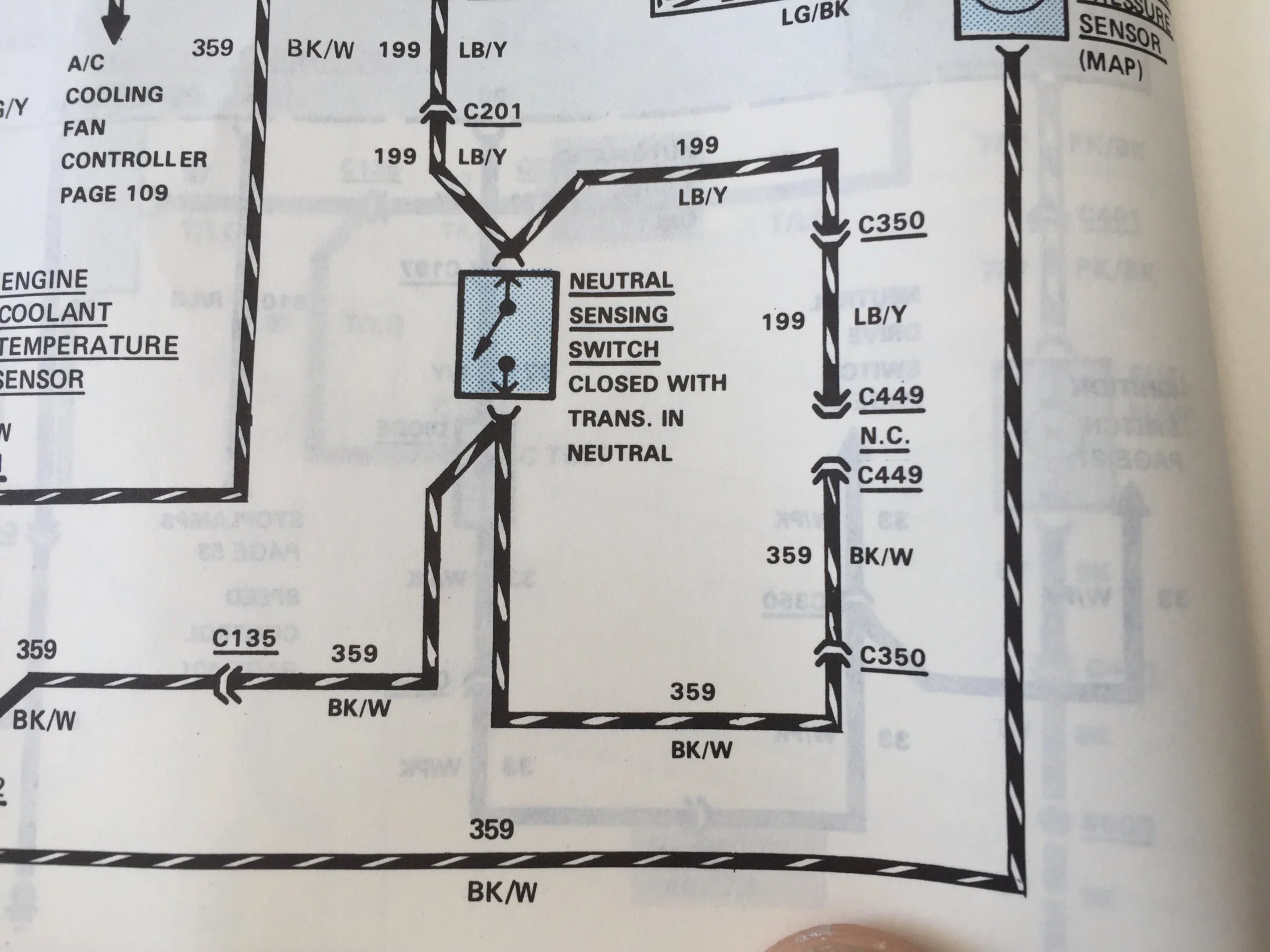

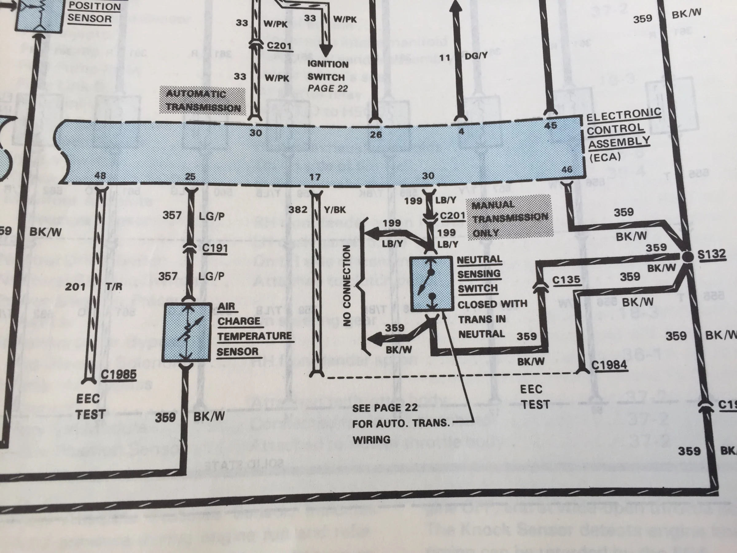

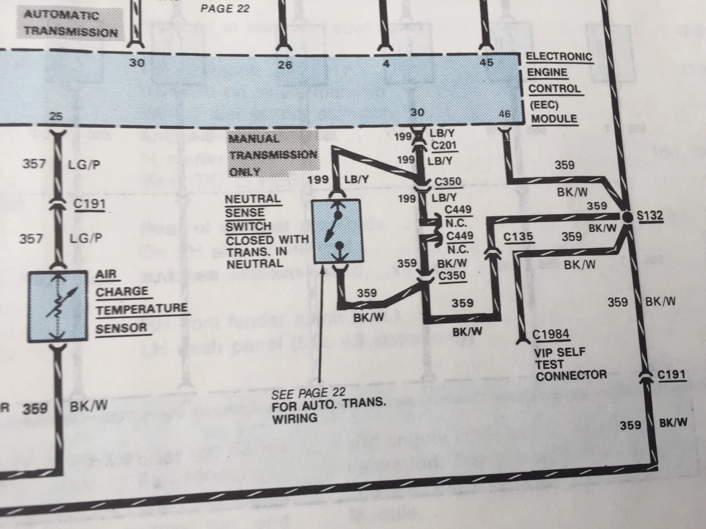

Well, not a whole lot of differences between the 5-wire 87 and early 88s and the later mass air style wiring in terms of o2 harness jumpers. The early cars just didn't send the wire there. C350 is where pin 30 from that start/stop circuit comes into play which burns up the ECU, and you can see on the manual cars the early wiring didn't send pin 30 through there.
1987 (and I assume early 1988)
1988
One thing I did note though. This is the 2.3L engine wiring, but did have me wondering if this also applied to the 5.0 given that I don't see parallel wiring for the clutch and trans switch.
1987
1988
According to this, the 1987 2.3L only uses the trans switch rather than parallel with clutch switch as in 1988-later. Assuming early 88's received 1987 wiring, I wonder what would happen if you jumped out the body side trans NGS harness connnrvtor under the car?

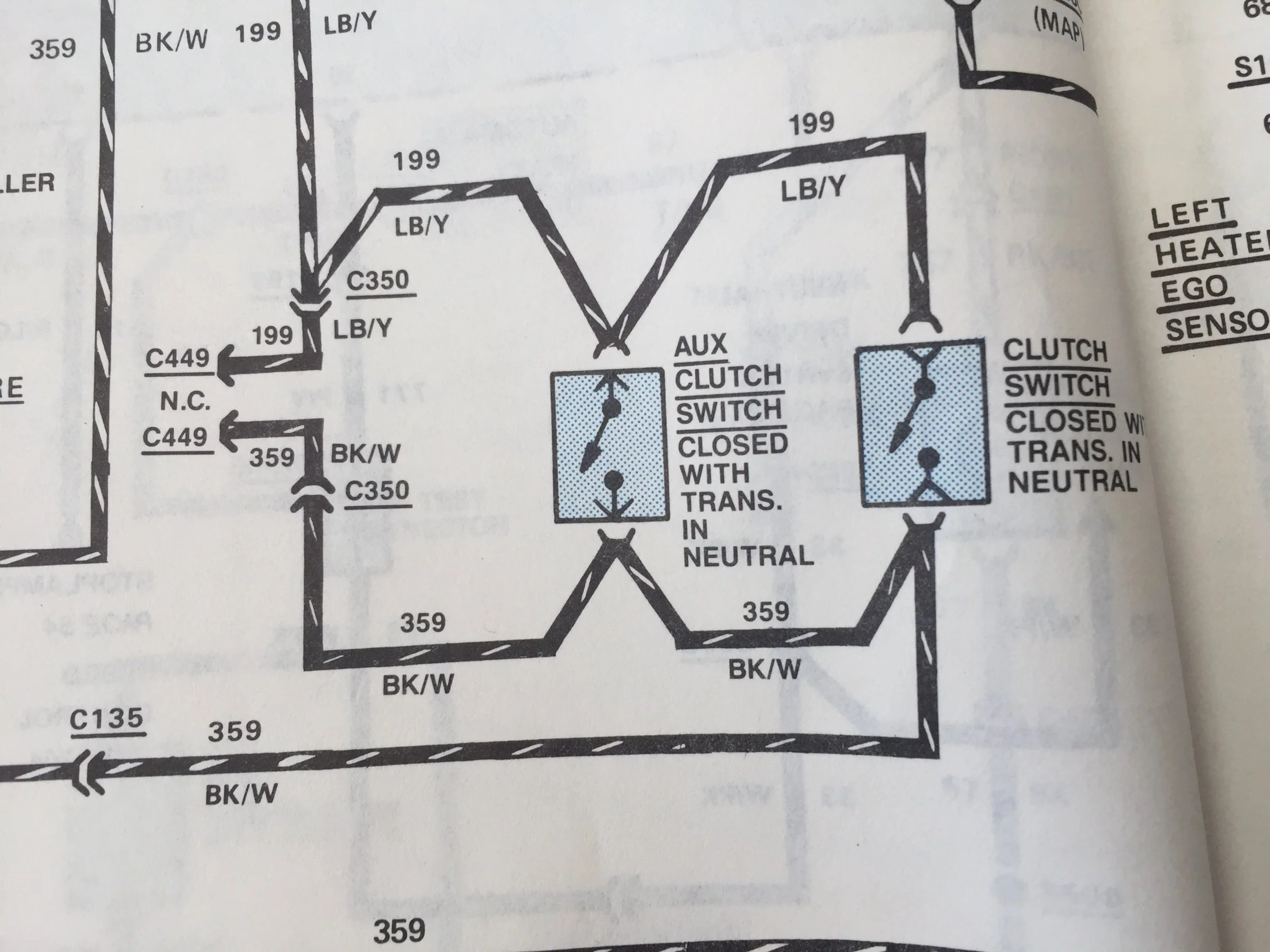

To see if mine is wired in parrallel do i just see if the clutch switch has the light blue/yellow tracer and black/white tracer going to it that the trans switch has? I'm also not getting voltage to the trans switch either. I unplugged the trans switch and checked the harness connector for voltage.
Mustang5L5
Mod Dude
Feb 18, 2001
43,351
18,086
224
Massachusetts
Jan 8, 2018
  • Jan 8, 2018
Yup, wire colors should be the same.
If you pull the driver's side kick panel, there's an 8-pin square plug located there that is the trans harness coming from under the car. You should see the wire colors there, and jumping them out there is much easier than going under the car.
Let me recheck wiring diagrams tonight and come up with something to test.
