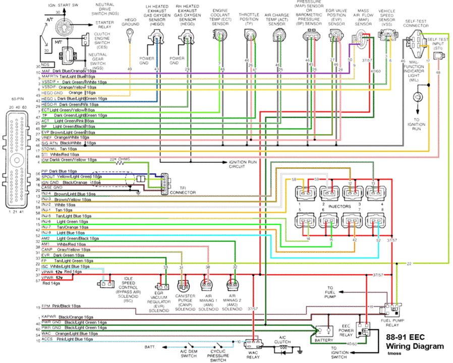

The computer is telling the snap-on scanner that my car is six banger....code 98 mix-match I.D....i tried swapping computers to a A9L didnt help. It must be a wiring issue..i need to know what color on the harness is causing this. or what pin, on the harness to computer? please help.....

Code 98 does not indicate a 6 cylinder computer. Here's what I found and where I got the info...
See http://www.troublecodes.net/Ford/ for more info
Code 98 - Did not pass KOEO yet (Get 11 in KOEO first)
Or see http://www.mustangworks.com/articles/electronics/eec-iv_codes.html
98 (r): Hard fault present. The PCM is running in FMEM (Failure Effects Management Mode), so something is royally screwed up that the KOEO test should have told you about. Rerun KOEO and fix whatever you find there.
No other codes other than 98 and the computeris getting good power, the computer is probably bad. Find a buddy to let you put your computer in his car and re-run the tests. That way, if something is messed up in your wiring or sensors, the computer will not fail in a good car and cause you to replace a good computer -

Here's what i think is the problem....head light switch went south...replaced switched...melting again...so i cut the melted wires and replaced...there must be a wire that got melted that goes to the A9P...sunday the dash must come-out....all burnt wires shall be replaced...i just wish i new what wires could cause the symtoms...so i could jump them...and bypass the burnt ones until sunday...

Bad power or low voltage to the computer could cause this problem.

Time to get out the digital voltmeter (DVM) & go hunting...
Diagram courtsey of Tmoss & Stand&2birds.
Pop the passenger side kick panel off and remove the plastic cover over the computer wiring. You will need the diagram above along with a safety pin to probe the wiring from the back side of the connector. Use the computer's case shield grond for a ground for the DVM. Check pins 37 & 57 (switched computer power) for battery voltage with the engine running. The difference between the voltage on pins 37 & 57 and the postive post of the battery should be less than .5 volt.
Check pin 19 for voltage with the engine off - you should see battery voltage. The difference between the voltage on pin 19 and the postive post of the battery should be less than .5 volt.
Check pins 40 & 60 (computer power ground) you should see less than .5 volt. More than this means the computer's power ground is bad. The computer has its own dedicated power ground that comes off the ground pigtail on the battery ground wire. It uses a barrel type quick disconnect connector inline with the battery ground pigtail. Due to it's proximity to the battery, it may become corroded by acid fumes from the battery.
The engine mounted sensors have a common separate ground. This includes the TPS, ACT, EGR, & BAP/MAP. These sensors share a black/white ground wire that connects to computer pin 46. With the power off, measure the resistance between pin 46 and the negative post on the batery. You should see less than .5 ohm.
The secondary power ground is between the back of the intake manifold and the driver's side firewall. It is often missing or loose. It supplies ground for the alternator and other electrical accessories such as the gauges. Any car that has a 3G alternator needs a 4 gauge ground wire running from the block to the chassis ground where the battery pigtail ground connects.
The O2 sensor heaters have their own ground (HEGO ground) coming from the computer. This is different and separate from the O2 sensor ground. It comes out of the fuel injector harness near the EGR valve.
