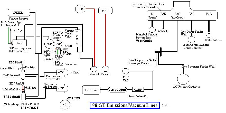

Ok, 33 says that the EGR did not open or respond...probabley improper vac?? And 41- system lean. Do these two coincide??? And I've seen the schematic for the vacuum lines but I'm getting somthing wrong w/ the EGR vac line... I think.

There should be no vacuum at the EGR valve when at idle. If there is, the EVR (electronic vacuum regulator) mounted on the backside of the passenger side wheelwell is suspect. Check the vacuum line plumbing to make sure the previous owner didn’t cross the vacuum lines.
Diagram courtesy of Tmoss & Stang&2birds. (the diagram says 88 GT, but the EGR part is the same for 86-93 Mustangs)

I'm working on getting the same damn codes off my car and I got a feeling there is a vac leak somewhere. I pulled the vac line off the egr and wasn't any suction I could feel going to the egr so maybe that is a good spot for you to check too, I dunno? But let me know what you find out about the two being related and I'll try to get back tomorrow after troubleshooting my car to see what kind of results I get
