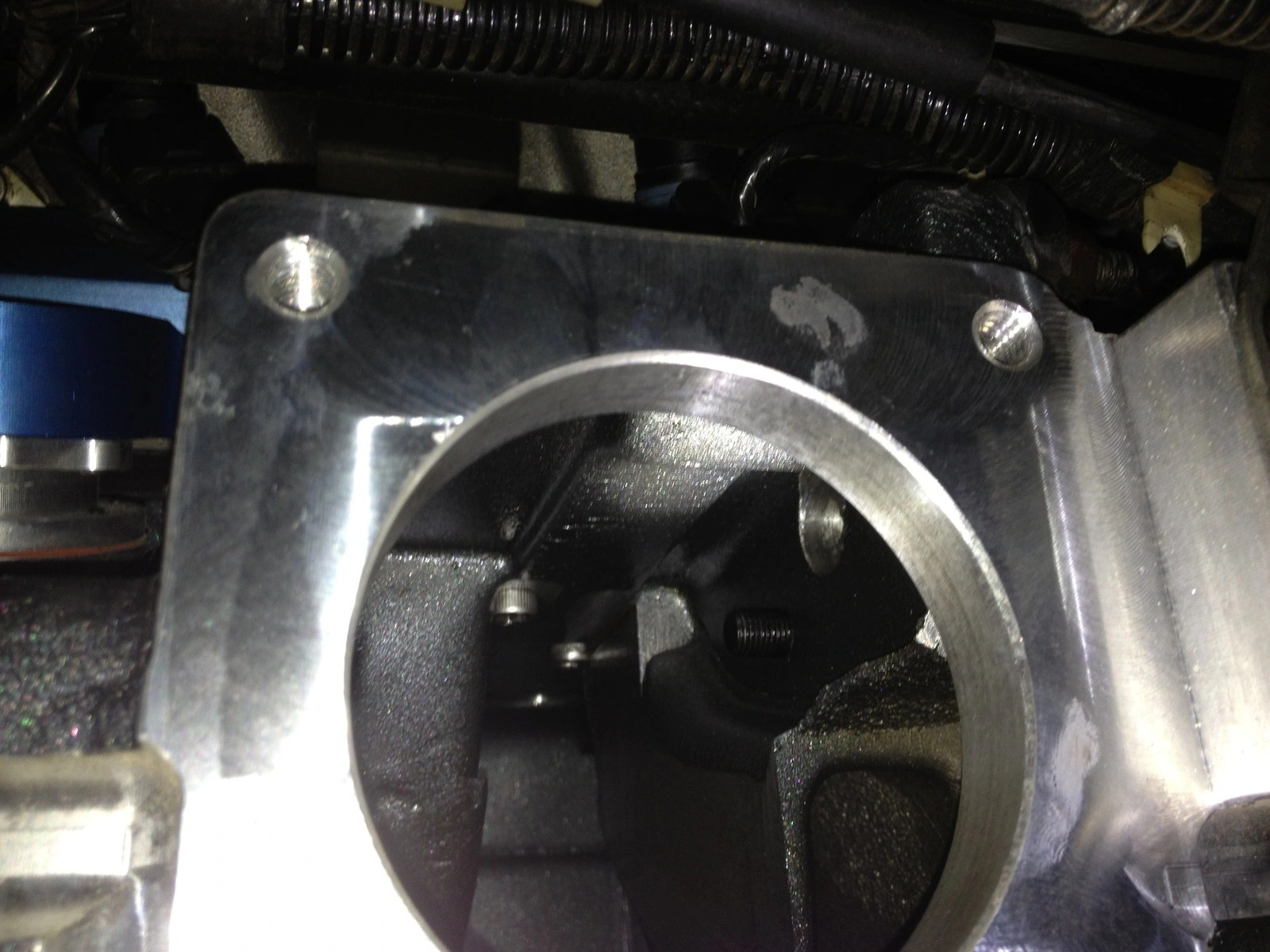

She's pulling oil from the valve cover to throttle body hose, through the intake, and what two cylinders are first to get the oil in the runners? Numbers 2 and 3. Picture is upside down. Stoopid iPhone.

1) Cleaned the oil off the #2 and #3 plugs
*helped*
2) Because of the oil in the intake and vacuum lines I bypassed PCV. Followed this:
http://mustangpartstech.com/Engine/BreathersandPCVDelete.html
*helped*
3) Because of the Code 18 I changed TFI Module on the distributor
*BAM! How about that Jack?*
