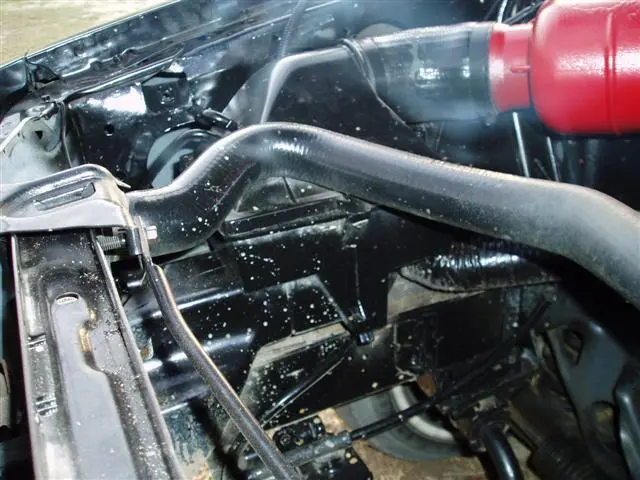

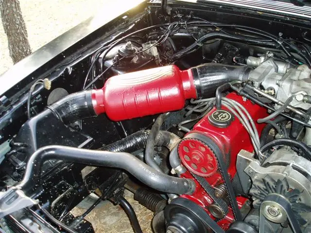

yep your right, all i want to do is replace the inline plastic piece from the tb to the air box. i have no maf sensor whatsoever on anything near the tubes or the airbox as you can see in the pics. so maybe thats whats throwing up my code? runs fine though, wish it was a little more responsive but not like my rx7 (w/turbo)
