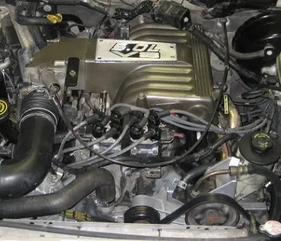

Blue85 Member Dec 25, 2020 86 13 18 Florida May 1, 2023 #1 May 1, 2023 #1 Do you think the coil would get too hot if mounted just above the intake? Never thought I would have a problem drilling holes in an engine bay. I really don’t want to. Attachments A6808F86-02C2-49B7-941A-279B0C024C15.webp 482.9 KB · Views: 164

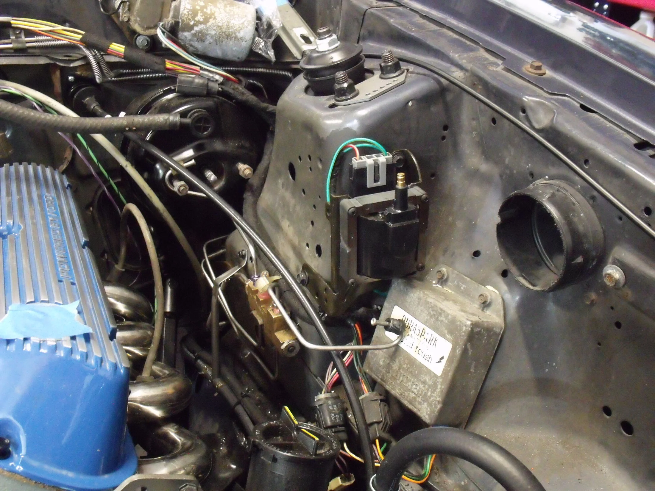

General karthief wonder how much it would cost to ship you a pair Mod Dude Aug 25, 2016 28,112 10,729 213 polk county florida May 1, 2023 #2 May 1, 2023 #2 The designers put the coil on the inner fender to remove heat and vibration issues that could (and did in some instances) occur. This is, of course, just a rumor and not based on any real evidence that I know of

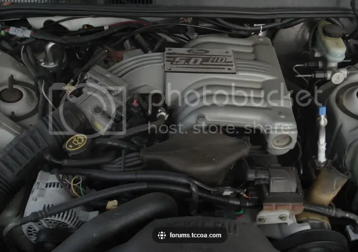

Mustang5L5 That is…until I whipped out my Bissell Mod Dude Feb 18, 2001 43,348 18,083 224 Massachusetts May 2, 2023 #4 May 2, 2023 #4 Ford somewhat put the coil over the intake on the 94/95 Mustang and on the 91-93 Cougarchicken. These are the same coils as our fox cars 5.0 exploreres use a different wasted spark type coil, but they are where the dist used to be. 4.6L Mustangs also use engine mounted coils, and moderns cars all literally stick the coils in the spark plug holes.

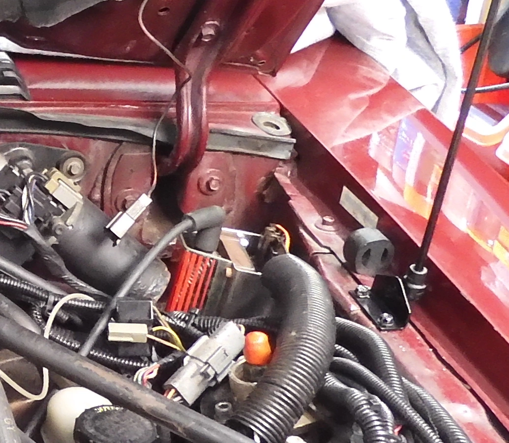

AeroCoupe lube between the nut and the face. I know my lubes Founding Member Oct 28, 2001 6,184 4,282 183 Claremore, OK May 2, 2023 #7 May 2, 2023 #7 I mounted a TFI coil on my carbureted 83 T-Bird like Limp did. Reactions: limp

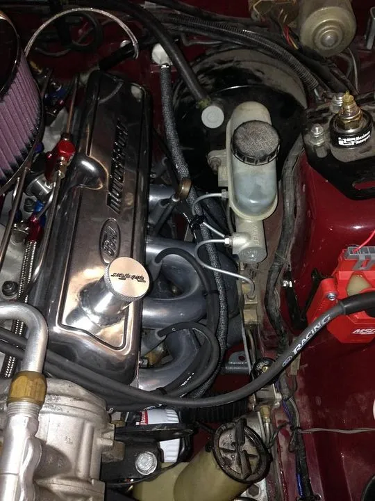

Blown88GT Founding Member Nov 13, 1999 2,283 524 164 Palm Beach Gardens, FL May 6, 2023 #10 May 6, 2023 #10 I left the original coil alone. Mounted the performance coil here. Needed a longer coil wire. Attachments DSCN0247_cr.webp 260.3 KB · Views: 130
