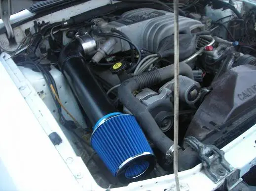

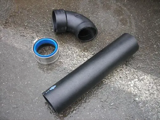

Make your own, PVC pipe. Its what JLT uses, they just make it look pretty and sophisticated then puts a huge price on it. Did it for my 86 5.0, then did it for the Sixxx. Probably about 20 bucks spent [if you dont already have some materials in the garage] each time after they were completed.
This was on my 86 hatchback. Simple materials, slapped a few coats of spraypaint and some rubber cement, installed, instant CAI. Worked awesome, I definately felt a difference, and even better that I always had nice cold air everyday [this was in Alaska]. No MAF setup here, it was a speed density car.
