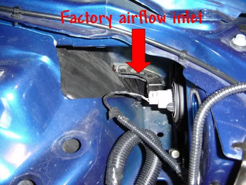

After reading over you're posts ! I can understand where your coming from, however I must respectfully disagree about what you posted, concerning how most CAI's get their air, from the exact same spot as the factory air-box is getting it's air from. Although, what you posted is indeed accurate ! You've overlooked one minor detail ? most CAI heat shields, such as the Steeda CAI..also draw air from the upper grille opening, in the corner on the driver's side, and also from the partial opening in the bottom as well. However other than for the very small opening in the fenderwell ! there's really no other place for air to be pulled into the stock airbox to reach the throttle body..Thanks to both the bottom and side sections of the airbox, being completely sealed off from the grille opening..Therefore, this leads me to believe that the stock airbox, is indeed very restrictive when compared to most aftermarket CAI's On the other hand, for what it's worth ? prior to purchasing my Steeda intake ! I had considered the WMS, for some of the same reasons you posted..But as far as I was concerned ? having to cut, and then splice into the factory wiring harness ! was just too high a price to pay IMHO..:shrug:
Here is a pic of the wimpy stock air inflow hole...
I will soon be adding a billet grill so that will allow that much more cool air to be forced into my intake.
