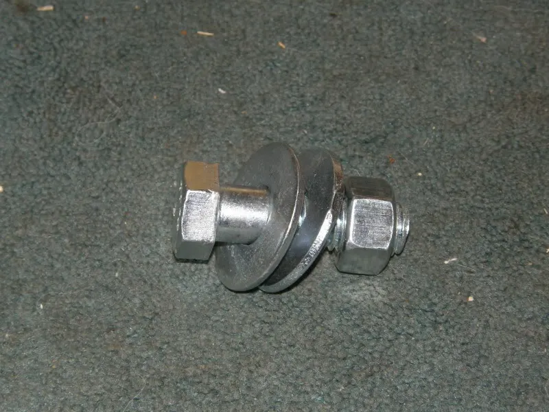

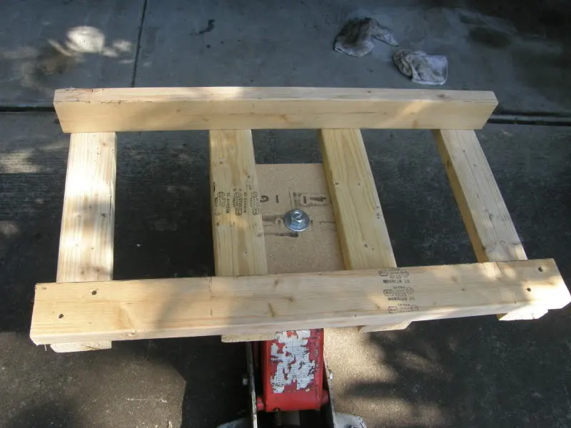

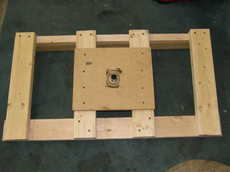

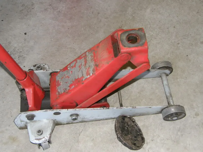

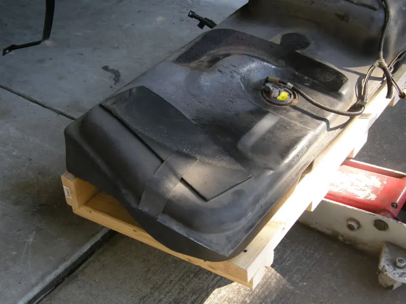

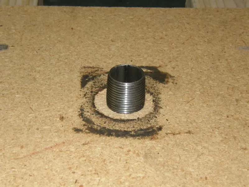

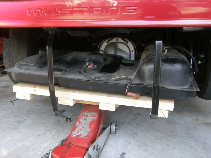

I'm a little late to the party but, if you ever need to pull your tank again spend 20 minutes and build a fuel tank cradle. I've used mine 4-5 times and it works flawlessly! You can pull it by yourself, it doesn't rock side to side and no need to drain the fuel. I've pulled and installed a couple of 3/4 full tanks. Most importantly you'll need a floor jack that has a removeable saddle. Other than that, some scrap lumber, a 1" pipe nipple and nut/bolt/washer assembly. It's like having a couple extra hands!
Yeah I was contemplating how to do something like this while doing it myself this time. I ended up putting a 2x10 edgewise up under one half and it helped a lot to stabilize but with two floor jacks it’s still rocking back and forth all over the place as I raise it into position and then you have to shove it onto the filler neck grommet. It does feel like an accomplishment getting it back in though. :D
