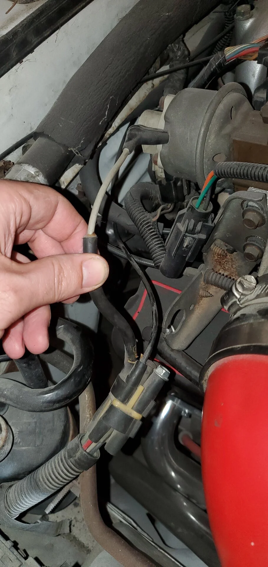

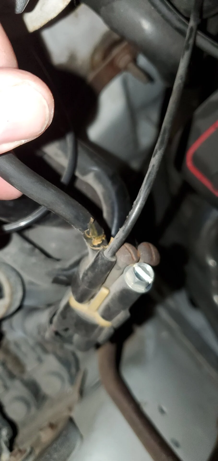

Did some research on code 84... looked at my car and took some pics. Any thoughts?

Last night I ordered an EGR Vacuum Solenoid (based on my code 84) and went ahead and ordered an EGR Valve and EGR Position Sensor. Just now I pulled the (original) EGR off and there was no Gasket to the Throttle Body... do I need one, I see some have a screen...? When I pulled the Position Sensor from the EGR the tip of the Sensor looks almost burned with some crud on it.
What are your thoughts to the last two pics I posted of that junction coming from the EGR... 3 screws in there as ‘plugs’ (not my doing) and what appears to be a crack in the line from the EGR...
The hard, colorful vac lines are getting brittle. Does anyone know if there is a repro assembly available or at least the hard line sections? I patched my car’s lines together to make everything functional again.
Those screws say something has been eliminated. Are the tad & tab solenoids still hooked up? I also wonder if the EGR is still getting proper vacuum.

The tab and tad are below the egr vacuum regulator solenoid correct? If so, yes they are connected
EDIT... I’m still learning the vacuum side of things... the TAB & TAD are there and connected like I said, but I would have to double check to see exactly how. For example, my canister is there but not hooked up (except for the line up to the Upper Intake by the Throttle Body) and smog has been removed, etc
