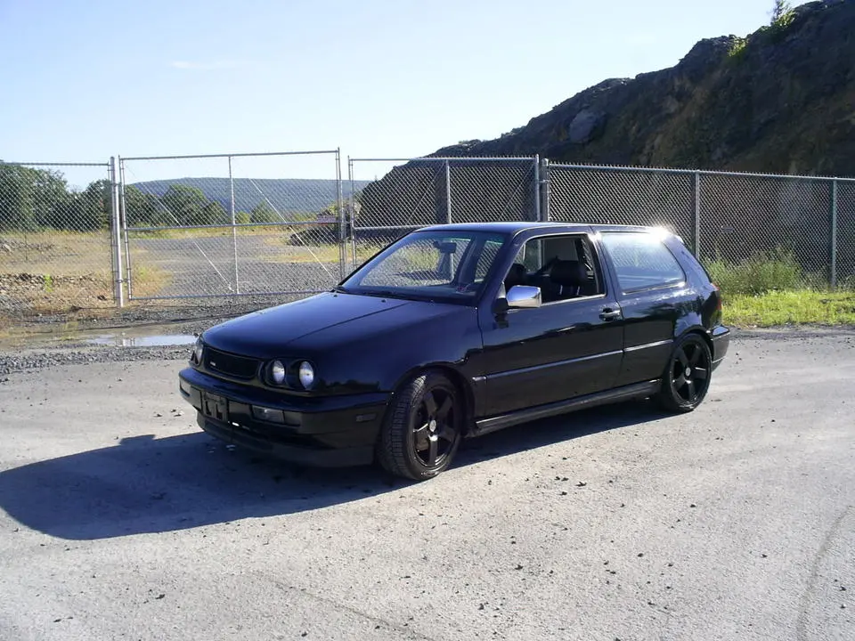

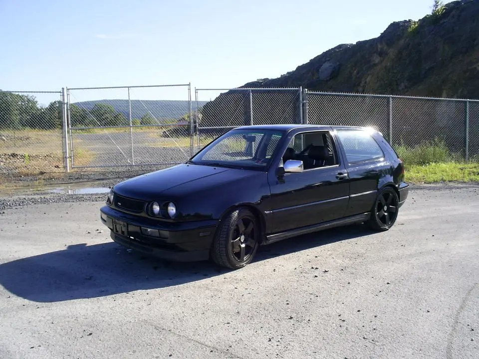

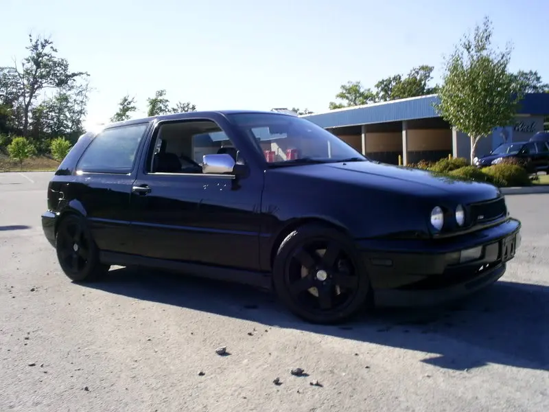

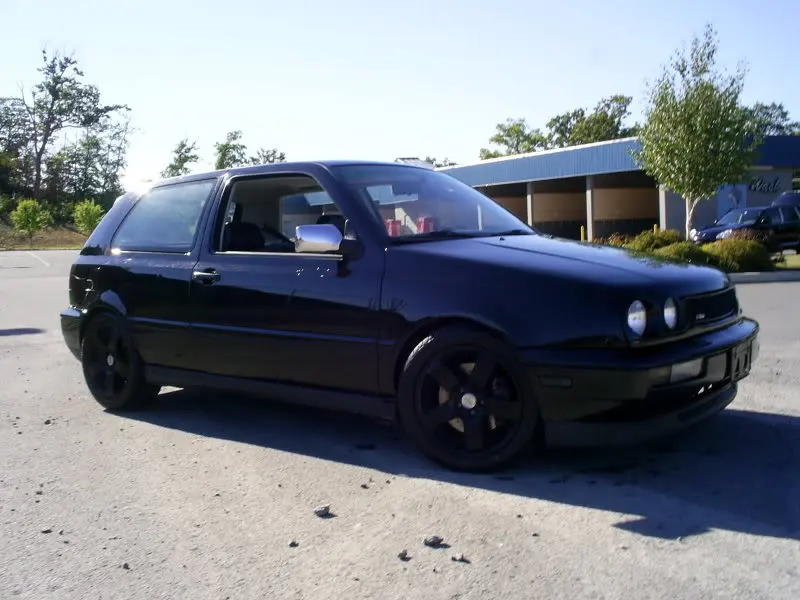

Also, there's no way i'm switching from royal purple, it works soo freakin good in my VR6, I simply cant resist using it in my other car. I dunno if I ever posted pics of it, here's my other baby, this is the car that owns in corners and highway races......not that I do that tho!.... :rlaugh:
Had winter tires on it in the pics with the black Konig's on her. Anyways point is, royal purple works so damn well in this car, I use it in the stang also. Like, I have either a timing chain guide or tenshioner broke, and the chains are loud, but with the purple in her she's nice and quiet, no other oil did that, also, when shifting at the red, she'd smoke a little, again, not with the purple, so, i'm a big fan of purple...gettin tired of typing the word tho.

Nice VW, those things can become little hotrods.

Yeah the dubb I just love, it's a very different experience. But i'm really only a fan of the MK3 VR6's, and the corrado. Not much into the others. But this car is great, and, runs pretty strong, especially above 80mph. Also, this, the 12V VR6, I think is the best sounding engine i've ever heard. Also I dont really like the 24V VR6's in the newer one's, the 12V is just fine for me, and defonantly pulls harder.
